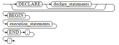

  • Enable an anonymous block.
    [DECLARE [declare_statements]]
    BEGIN
    execution_statements
    END;
