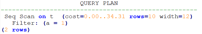

Forcibly use the custom plan.
2
3
create table t (a int, b int, c int);
prepare p as select /*+ use_cplan */ * from t where a = $1;
explain execute p(1);
In the following plan, the filtering condition is the actual value of the input parameter, that is, the plan is a custom plan.

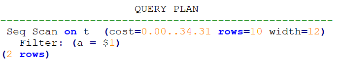

Forcibly use the generic plan.
2
3
deallocate p;
prepare p as select /*+ use_gplan */ * from t where a = $1;
In the following plan, the filtering condition is the input parameter to be added. That is, the plan is a generic plan.
