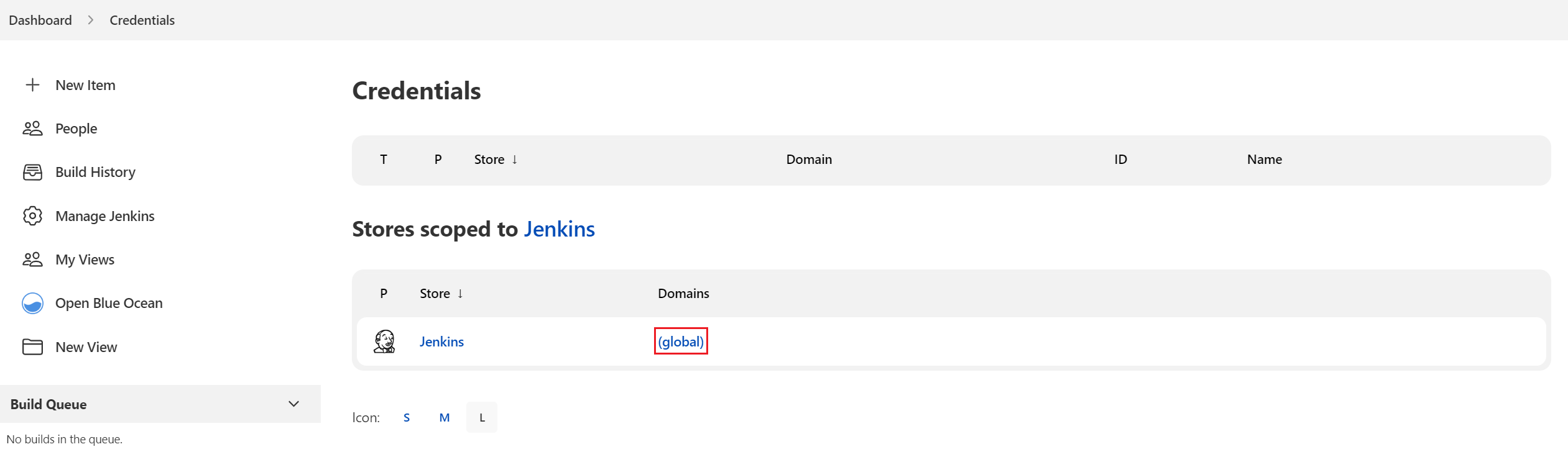

Verify whether the permissions meet the expectation in Jenkins.
  1. On the Jenkins dashboard page, click Manage Jenkins, choose Security > Manage Credentials, and click the default global credential storage domain of Jenkins. You can also create a domain.
  2. Click Add Credentials. Set Kind to Secret file, Scope to Global (Jenkins, nodes, items, all child items, etc), and File to the downloaded kubeconfig configuration file, retain the default values for other parameters, and click Create.
  3. Start the Jenkins job. In this example, Jenkins fails to be deployed in namespace default but is successfully deployed in namespace dev.
