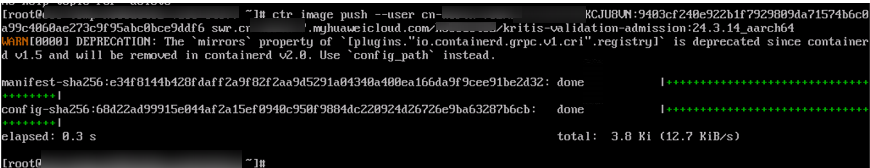

  • Method 1: Run docker push (Docker) or ctr push (containerd) on the server where the container engine client is installed to push an image to SWR. This method is a good choice for large images.
    The push can be implemented over an intranet or the Internet. For details, see Configuring Access Network.

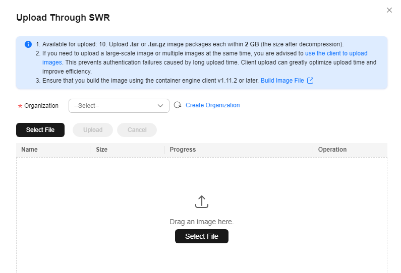

  1. Log in to the SWR console.
  2. In the navigation pane, choose My Images. Then click Upload Through SWR.
  3. In the displayed dialog box, select an organization. Then, click Select File to upload an image file.
    If you select multiple images, they will be uploaded one by one. Concurrent upload is not supported.
    Figure 1 Uploading an image on the SWR console
  4. Click Upload.
    If Completed is displayed, the image is uploaded successfully.
