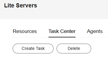

  1. Log in to the ModelArts console. In the navigation pane, choose Resource Management > Lite Compute Resources > Lite Servers. Go to Task Center.
  2. Click Create Task in the upper right corner. On the displayed Job Templates page, locate Ascend Stress Testing, and click Create Task.

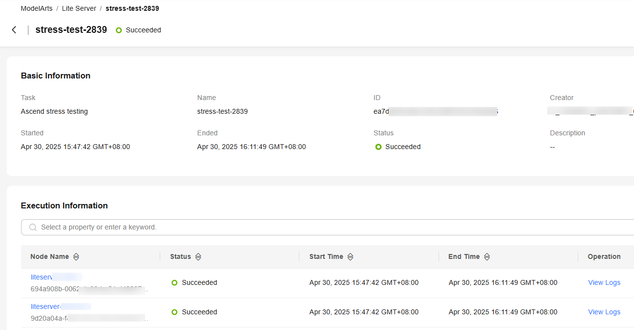

  4. View the task execution status in the Task Center tab.
  5. Click the task name to access its details page, where you can view the task details.
  6. On the task details page, locate the target node and click View Logs in the Operation column. In the displayed window on the right, view the detailed log about task execution.
