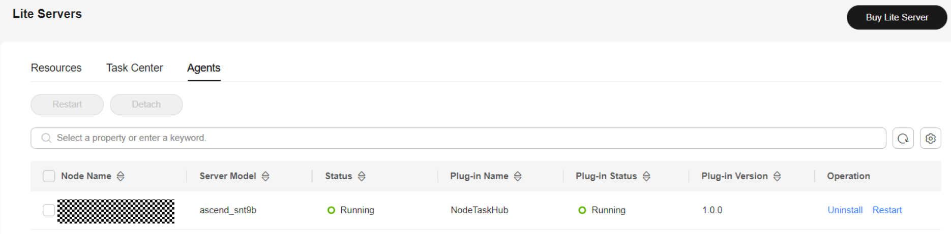

- Log in to the ModelArts console. In the navigation pane, choose Resource Management > Lite Compute Resources > Lite Servers.
- On the plugin management page, check whether the plugin has been installed. If not, click Install in the Operation column on the right and install the plugin as prompted. Alternatively, manually install it by referring to Installing a Plug-in Manually.
- In the navigation pane on the left, choose Resource Management > Auxiliary Tools > Plugin Marketplace. Search for the NodeTaskHub plugin and click Install. Figure 1 Searching for the plug-in
- Select the plugin version as prompted and copy the one-click installation command and execute it on the Lite Server to install NodeTaskHub.
To prevent routing conflicts from causing network failures, ensure that the VPC subnet of the Lite Server's primary NIC does not overlap with the NodeTaskHub runtime subnet (172.17.0.0/16).
- After the plug-in is installed, return to the Plugins tab. The plug-in is in the Running state.
Related Operations
In the navigation pane on the left, choose Resource Management > Lite Servers. Click the Plugins tab. You can restart, uninstall, and upgrade plugins.
