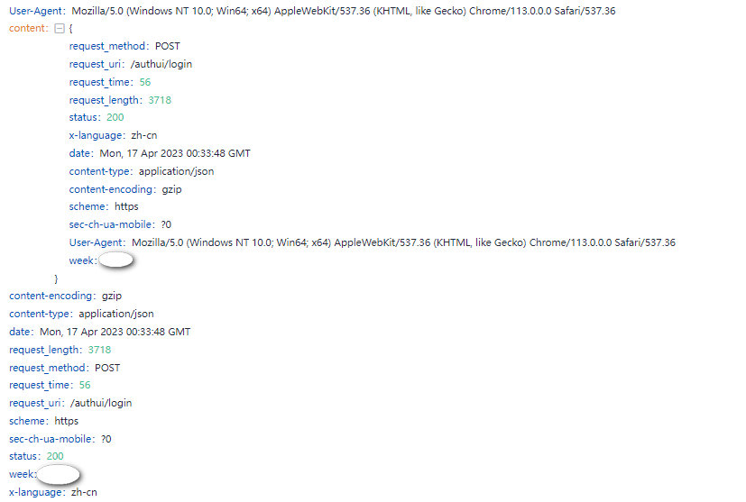

Examples
Table 5 Search description
Search Requirement
Search Statement
Search for logs whose User-Agent field value contains Mon, 17 Apr 2023.
User-Agent:#"Mon, 17 Apr 2023"
Search for logs whose User-Agent field value contains Mozilla/5.0.
User-Agent:#"Mozilla/5.0"
Search for logs whose week field value contains Monday.
week:#"Monday"
