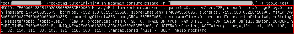

- Consume normal messages using the sample project.
sh mqadmin consumeMessage -n "${Connection addresses}" -t ${Topic name}
Run the following command with the values obtained in Table 1 to consume normal messages:
sh mqadmin consumeMessage -n "11.xxx.xxx.89:8200;11.xxx.xxx.144:8200" -t topic-test
The message is consumed when the information in the red box shown in the following figure is displayed.
To stop consuming messages, press Ctrl+C to exit.

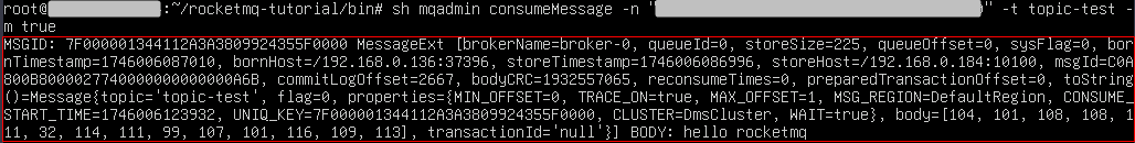

- Retrieve messages and send the message traces using the sample project.
sh mqadmin consumeMessage -n "${Connection addresses}" -t ${Topic name} -m true
Run the following command with the values obtained in Table 1 to consume messages with traces:
sh mqadmin consumeMessage -n "11.xxx.xxx.89:8200;11.xxx.xxx.144:8200" -t topic-test -m true
