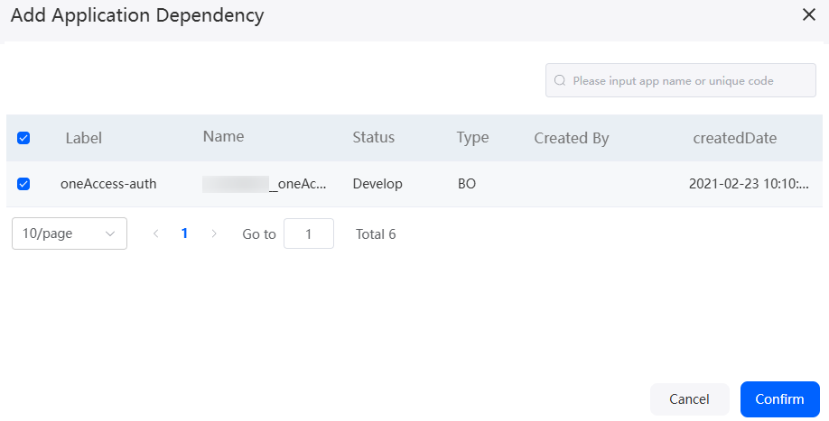

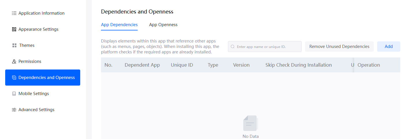

- Choose Dependencies and Openness and click Add. The page for adding application dependencies is displayed. Figure 1 Adding application dependencies
- Select one or more applications for which you want to add dependencies and click Confirm. Figure 2 Selecting the application to which the dependency is to be added
- (Optional) On the App Dependencies tab page, click
next to the added application to view the dependent application. - (Optional) On the App Dependencies tab page, click
next to the added application to delete the dependent application. If the current application has added a dependency relationship with another application but does not reference any element in the application, you can click this button to delete the false dependency relationship at a time.

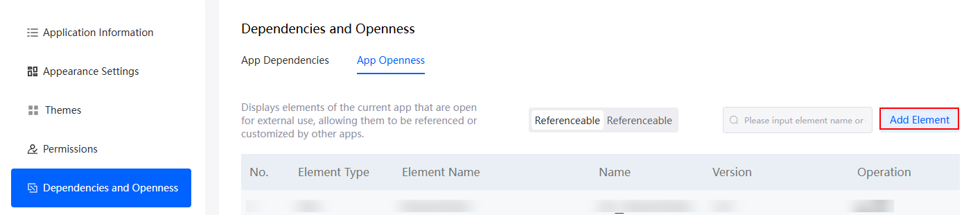

- Choose Dependencies and Openness. Choose App Openness > Referenceable and click Add Element. Figure 3 Adding an element that can be referenced
- On the page for adding elements, select the target element and click Confirm.
