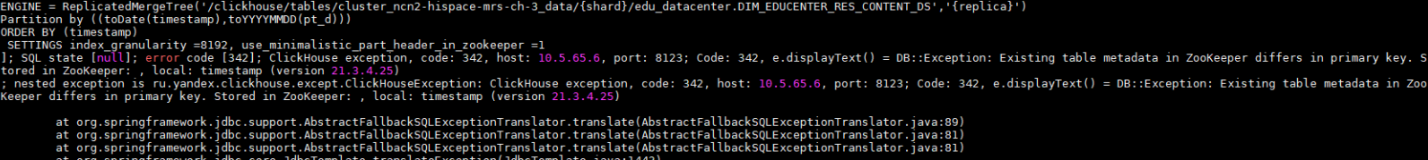

When a ClickHouse replicated table is deleted and then recreated, the error message "Existing table metadata in ZooKeeper" is displayed.
