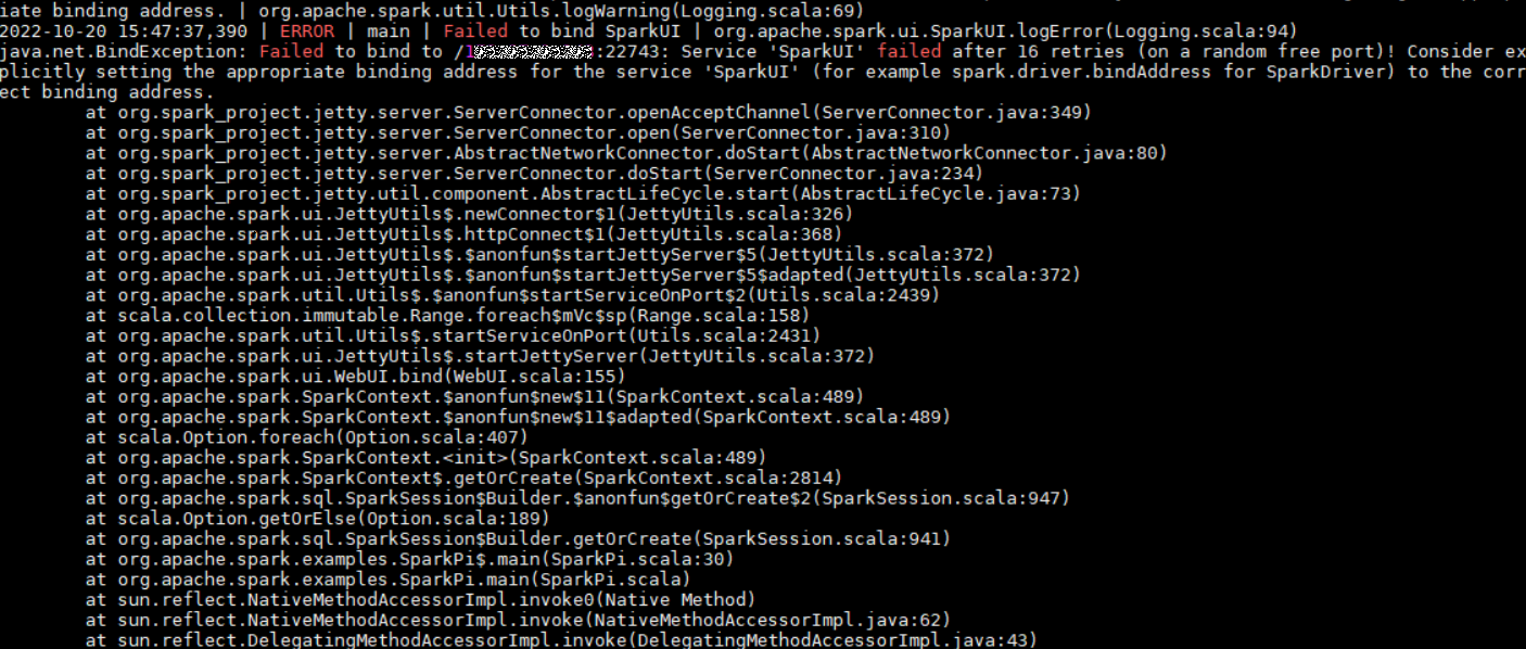

When a client outside the cluster is installed or used, the Spark task port sometimes fails to be connected.
Exception information: "Failed to bind SparkUi"
Cannot assign requested address: Service 'sparkDriver' failed after 16 retries (on a random free port)! Consider explicitly setting the appropriate binding address for the service 'sparkDriver' (for example spark.driver.bindAddress for SparkDriver) to the correct binding address.

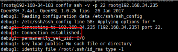

  • Possible cause 3: If the port is already in use, each Spark will occupy a new Spark UI port. The default port is 22600. If that is taken, increase the port number in sequence and try again. However, there are only 16 retries by default. After the 16 retries, this task is aborted.
    Check whether the port is in use.
    ssh -v -p port username@ip
    If the message "Connection established" appears, it means that the connection was successful and the port is in use.
    The Spark UI port range is determined by the spark.random.port.min and spark.random.port.max parameters in the spark-defaults.conf configuration file. If all ports in the range are used, no port is available and the connection fails.
