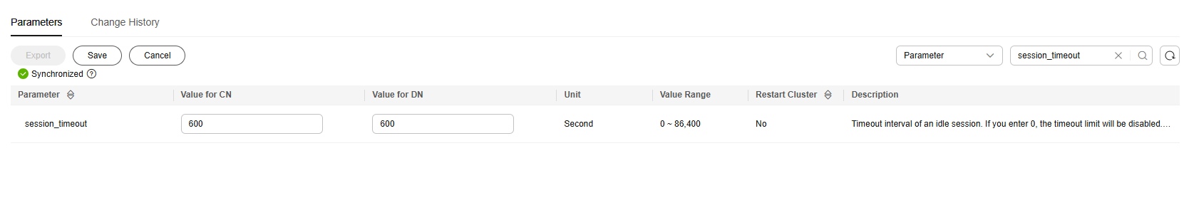

Handling method: Check the network status, rectify the network fault, and rectify the factors that affect the database connection timeout, for example, check the database parameter session_timeout.
- Log in to the DWS console.
- Choose Cluster > Cluster List in the navigation pane.
- In the cluster list, find the target cluster and click the cluster name. The Cluster Information page is displayed.
- Click Parameter Modifications and view the value of session_timeout in the parameter list.
- Set the CN and DN values of session_timeout to 0 to disable the timeout setting.
