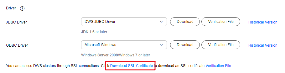

  1. Log in to the DWS console. In the navigation pane, choose Management > Client Connections.
  2. In the Driver area, click download an SSL certificate.
    Figure 1 Downloading an SSL certificate
  3. Use a file transfer tool (such as WinSCP) to upload the SSL certificate to the host where the client is installed.
    For example, save the downloaded certificate dws_ssl_cert.zip to the /home/dbadmin/dws_ssl/ directory.
