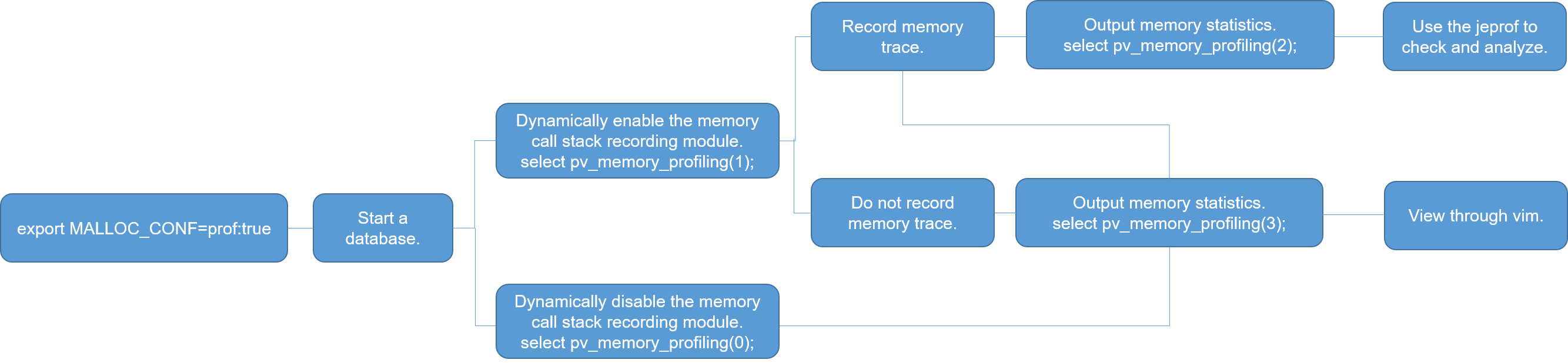

The pv_memory_profiling(type int) and environment variable MALLOC_CONF are used by GaussDB(DWS) to control the enabling and disabling of the memory allocation call stack recording module and the output of the memory call stack. The following figure illustrates the process.

Commands for enabling and disabling MALLOC_CONF:
  • Enabling the monitoring module:
    export MALLOC_CONF=prof:true
  • Disabling the monitoring module:
    export MALLOC_CONF=prof:false
