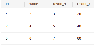

DROP TABLE IF EXISTS test_data;
CREATE TABLE test_data (id serial, value int);
INSERT INTO test_data (value) VALUES (2), (4), (6);
SELECT id, value, (compute(value)).*
FROM test_data ORDER BY 1;
