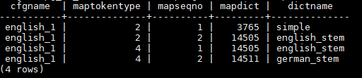

Query text search configurations.
SELECT b.cfgname,a.maptokentype,a.mapseqno,a.mapdict,c.dictname FROM pg_ts_config_map a,pg_ts_config b, pg_ts_dict c WHERE a.mapcfg=b.oid AND a.mapdict=c.oid AND b.cfgname='english_1' ORDER BY 1,2,3,4,5; |
