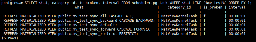

  2. View the scheduled update task.
    SELECT what, category_id, is_broken, interval FROM scheduler.pg_task WHERE what LIKE '%mv_test%' ORDER BY 1;

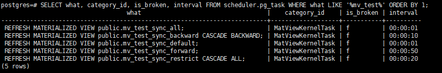

  3. Modify the cascading refresh mode.
    ALTER MATERIALIZED VIEW mv_test_sync_backward REFRESH START WITH('2020-01-01 15:15:15'::timestamptz) EVERY (interval '10 s') ;
    ALTER MATERIALIZED VIEW mv_test_sync_restrict REFRESH cascade all START WITH('2020-01-01 12:12:12'::timestamptz) EVERY (interval '20 s') ;
    ALTER MATERIALIZED VIEW mv_test_sync_all REFRESH  default;
    ALTER MATERIALIZED VIEW mv_test_sync_forward REFRESH default START WITH('2020-01-01 12:12:12'::timestamptz) EVERY (interval '50 s') ;
