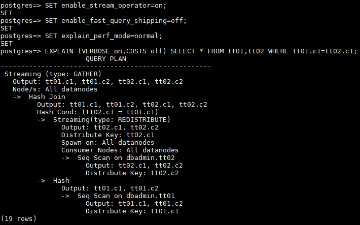

Type 3: Stream plan, no data exchange between DNs
Two tables are joined, and the join condition is the distribution column of each table. DNs do not need to exchange data. After generating a stream plan, the CN delivers the plan except the Gather Stream part to DNs for execution. The CN scans the base table on each DN, performs hash join, and sends the result to the CN.

SET enable_fast_query_shipping=off;
SET enable_stream_operator=on;
EXPLAIN (VERBOSE on,COSTS off) SELECT * FROM tt01,tt02 WHERE tt01.c1=tt02.c2;
                     QUERY PLAN
 Streaming (type: GATHER)
   Output: tt01.c1, tt01.c2, tt02.c1, tt02.c2
   Node/s: All datanodes
   ->  Hash Join
         Hash Cond: (tt01.c1 = tt02.c2)
         ->  Seq Scan on dbadmin.tt01
               Distribute Key: tt01.c1
         ->  Hash
               Output: tt02.c1, tt02.c2
               ->  Seq Scan on dbadmin.tt02
                     Distribute Key: tt02.c2
(14 rows)

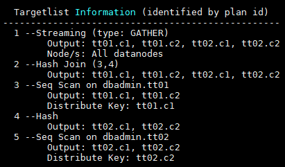

  5. Targetlist Information (identified by plan id)
    This part displays the output target column information of each operator.

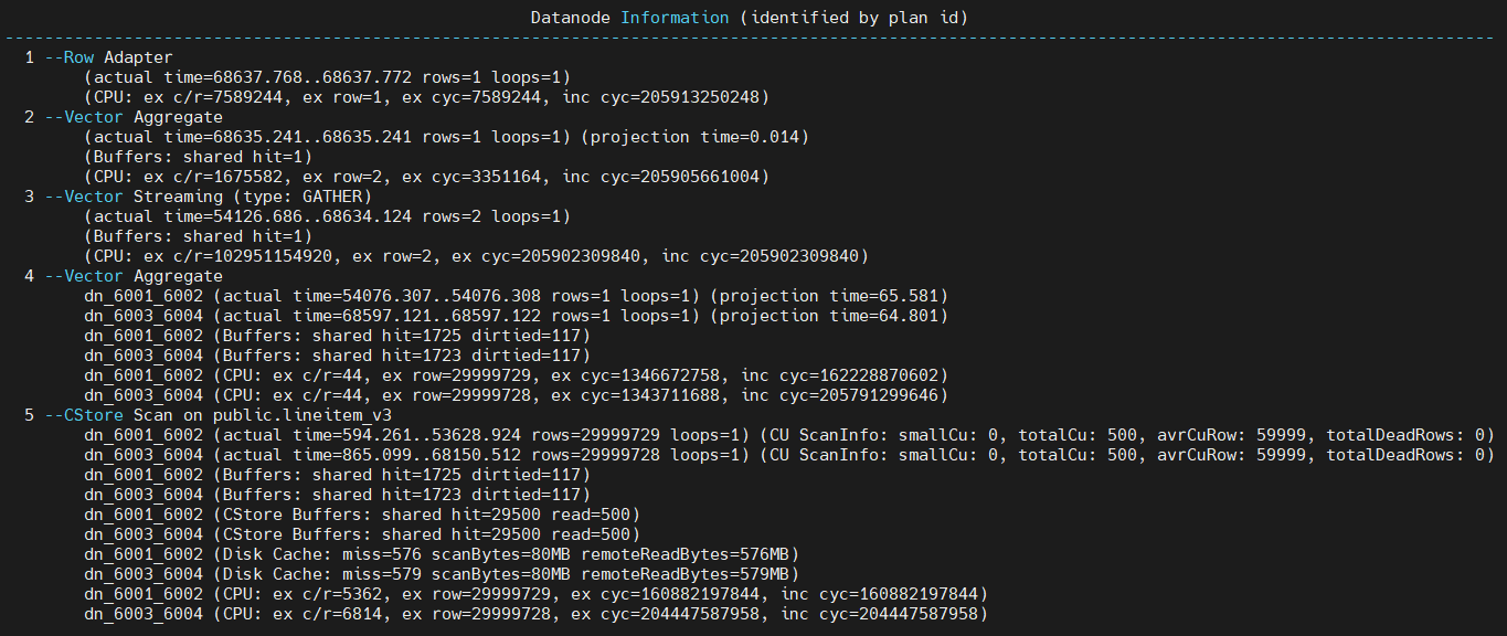

  6. DataNode Information (identified by plan id)
    This part displays the execution time of each operator (including the execution time of filtering and projection, if any), CPU usage, and buffer usage.
    • Operator execution information
      The execution information of each operator consists of three parts:
      • dn_6001_6002/dn_6003_6004 indicates the information about the execution node. The information in the brackets is the actual execution information.
      • actual time indicates the actual execution time. The first number indicates the duration from the time when the operator is executed to the time when the first data record is output. The second number indicates the total execution time of all data records.
      • rows indicates the number of output data rows of the operator.
      • loops indicates the number of execution times of the operator. Note that for a partitioned table, scan on each partition is counted as a scan. Scan on a new partition is counted as a new scan.
    • CPU information
      Each operator execution process has CPU information. cyc indicates the number of CPU cycles, and ex cyc indicates the number of cycles of the current operator, excluding its subnodes. inc cyc indicates the number of cycles, including subnodes, ex row indicates the number of data rows output by the current operator, and ex c/r indicates the mean of ex cyc and ex row.
    • Buffer information
      Buffers indicates the buffer information, including the read and write operations on shared blocks and temporary blocks.
      Shared blocks contain tables and indexes, and temporary blocks are disk blocks used in sorting and materialization. The number of blocks displayed on the upper-layer node contains the number of blocks used by all its subnodes.
    • Disk cache information (supported only by V3 tables or foreign tables with decoupled storage and compute and colversion set to 3.0 in 9.1.0.100 or later)
      Disk Cache indicates the hit information and data read information of the disk cache. (supported by V3 tables or foreign tables with storage and compute decoupled)
      miss indicates the number of disk cache misses. hit indicates the number of disk cache hits. For details about errorCode, see disk_cache_error_code in Table 1. error indicates the number of times errorCode is generated. scanBytes indicates the amount of data queried by scan, remoteReadBytes indicates the amount of data read on OBS, and loadTime indicates the time for loading data from the disk cache. To improve OBS efficiency, adjacent request blocks are combined. Alternatively, the minimum granularity for writing requests to the disk cache is block (1 MB by default). As a result, the value of scanBytes may be less than that of remoteReadBytes.
      Column 3.0: prefetch parameters and prefetch process information of V3 tables with storage and compute decoupled. (This parameter is supported only by V3 tables with storage and compute decoupled and is displayed after prefetch parameters are enabled.)
      preloadStep indicates the prefetch step, preloadSubmitTime indicates the I/O request submission time in the prefetch process, preloadWaitTime indicates the I/O request waiting time in the prefetch process, and preloadWaitCount indicates the number of waiting I/O requests in the prefetch process.
      OBS I/O indicates details about an OBS I/O request. (supported by V3 tables or foreign tables with storage and compute decoupled)
      count indicates the total number of OBS I/O requests. averageRTT indicates the average round trip time (RTT) of OBS I/O requests. The unit is μs. averageLatency indicates the average latency of OBS I/O requests. The unit is μs. latencyGt1s indicates the number of OBS I/O requests whose latency exceeds 1s. latencyGt10s indicates the number of OBS I/O requests whose latency exceeds 10s. retryCount indicates the total number of OBS I/O request retries. rateLimitCount indicates the total number of times that OBS I/O requests are under flow control.

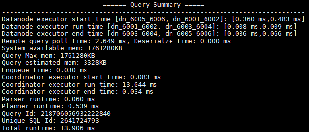

  7. User Define Profiling
    User-defined information, including the time when CNs and DNs are connected, the time when DNs are connected, and some execution information at the storage layer.
  8. Query Summary
    The total execution time and network traffic, including the maximum and minimum execution time in the initialization and end phases on each DN, initialization, execution, and time in the end phase on each CN, and the system available memory during the current statement execution, and statement estimation memory information.
    • DataNode executor start time: DN executor start time. The format is [min_node_name, max_node_name]: [min_time, max_time].
    • DataNode executor run time: DN executor running duration. The format is [min_node_name, max_node_name]: [min_time, max_time].
    • DataNode executor end time: DN executor end time. The format is [min_node_name, max_node_name]: [min_time, max_time].
    • Remote query poll time: poll waiting time for receiving results.
    • System available mem: available system memory
    • Query Max mem: maximum query memory
    • Enqueue time: enqueuing time
    • Coordinator executor start time: CN executor start time
    • Coordinator executor run time: CN executor running duration
    • Coordinator executor end time: CN executor end time
    • Parser runtime: parser running duration
    • Planner runtime: optimizer execution duration
    • Network traffic: amount of data sent by the stream operator
    • Query Id: query ID
    • Unique SQL ID: constraint SQL ID
    • Total runtime: total execution duration
  • The difference between A-rows and E-rows shows the deviation between the optimizer estimation and actual execution. Generally, if the deviation is large, the plan generated by the optimizer cannot be trusted, and you need to modify the deviation value.
  • If the difference of the A-time values is large, it indicates that the operator computing skew (difference between execution time on DNs) is large and that manual performance tuning is required. Generally, for two adjacent operators, the execution time of the upper-layer operator includes that of the lower-layer operator. However, if the upper-layer operator is a stream operator, its execution time may be less than that of the lower-layer operator, as there is no driving relationship between threads.
  • Max Query Peak Memory is often used to estimate the consumed memory of SQL statements, and is also used as an important basis for setting a memory parameter during SQL statement optimization. Generally, the output from EXPLAIN ANALYZE or EXPLAIN PERFORMANCE is provided for the input for further optimization.
