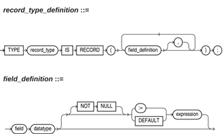

Perform the following operations to create a record variable:
Define a record type and use this type to declare a variable.
Syntax
For the syntax of the record type, see Figure 1.
The syntax is described as follows:
- record_type: record name
- field: record columns
- datatype: record data type
- expression: expression for setting a default value
