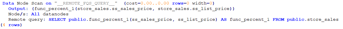

Run the following statement:
2
SELECT func_percent_1(ss_sales_price, ss_list_price)
FROM store_sales;
The execution plan is as follows:
func_percent_1 is pushed down to DNs for quicker execution. (In TPCDS 1000X, where three CNs and 18 DNs are used, the query efficiency is improved by over 100 times).
