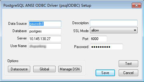

 - Configure the data source.
On the User DSN tab, click Add, and choose PostgreSQL Unicode for setup. (An identifier will be displayed for the 64-bit OS.)
      The entered username and password will be recorded in the Windows registry and you do not need to enter them again when connecting to the database next time. For security purposes, you are advised to delete sensitive information before clicking Save and enter the required username and password again when using ODBC APIs to connect to the database.

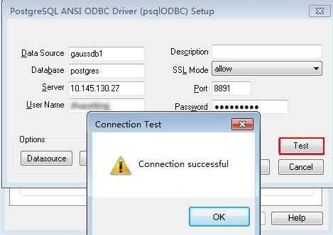

Testing Data Source Configuration
Click Test.
