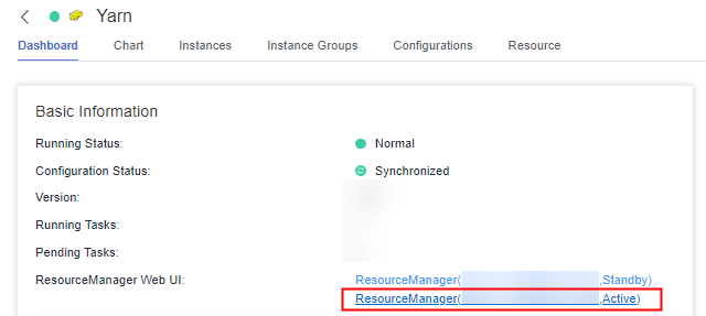

- Log in to FusionInsight Manager as the user who has the permission to view tasks.
For details about how to log in to FusionInsight Manager, see Accessing MRS FusionInsight Manager.
- Choose Cluster > Services > Yarn.
- In the Basic Information area, click ResourceManager(xxx,Active) to go to the YARN web UI.
Figure 1 Accessing the YARN web UI

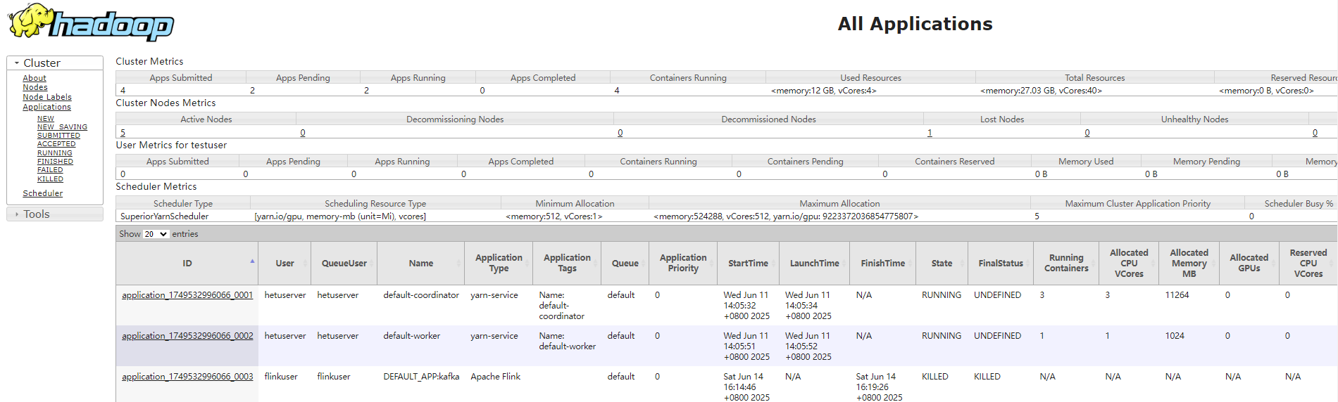

- Viewing job overview information:
- On the YARN web UI, the All Applications page is displayed by default. You can view the cluster metrics, cluster node metrics, user metrics for username, scheduler metrics, and job list.
- In the job list, you can view the job submission user, job submission time, job status, and job memory usage.
- Click Applications in the navigation pane on the left to filter jobs in different states.
Figure 2 Viewing All Applications information - Viewing details about a single job:

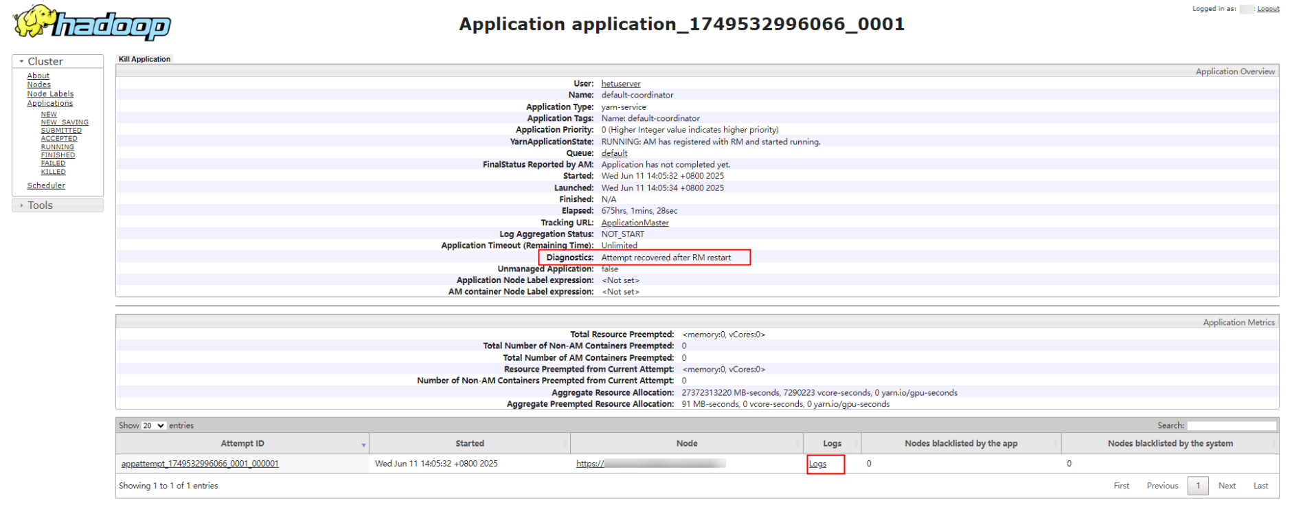

Click the application ID, for example, application_xxx_0001, in the job list to view details about the job.
- The Diagnostics area displays the exception diagnosis information about the current job.
- Click Logs in the list area to view job logs.
Figure 3 Viewing job details - Viewing YARN queue information:
