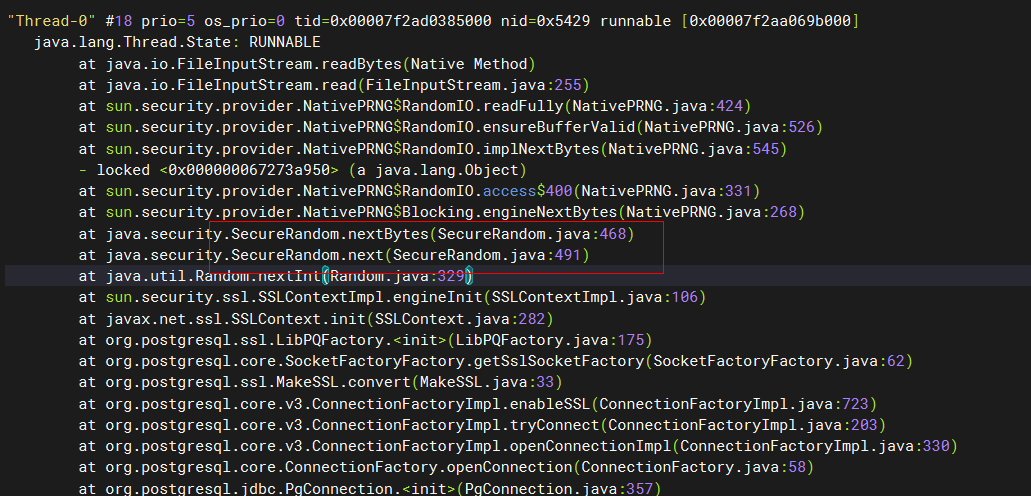

When JDBC establishes a connection in SSL mode, a strong random number is obtained on the client. During the connection establishment, the following error information may be reported.
Scenario 1: Error report.
Scenario 2: The connection is blocked. If loginTimeout is set in the connection string, the message "Connection attempt timed out" is displayed. If this parameter is not set, the connection is blocked.

The random number generation on the client is too slow to meet product requirements. The entropy source is insufficient. As a result, the service fails to be started. This problem exists in some Linux environments.
Solution
Solution 1: Start the haveged service on the client and increase the entropy value of the system entropy pool to improve the speed of reading random numbers. The startup command is as follows:
systemctl start haveged
Method 2: Adjust the JDK configuration on the client.
Open the $JAVA_PATH/jre/lib/security/java.security file and modify the following configuration items:
securerandom.source=file:/dev/./urandom securerandom.strongAlgorithms=NativePRNGNonBlocking:SUN
   The essence of solution 2 is to use pseudo-random numbers instead of strong random numbers to reduce the entropy value to be consumed. All applications that use the JDK on the client are affected. Pseudo-random numbers are used to instead of strong random numbers.
