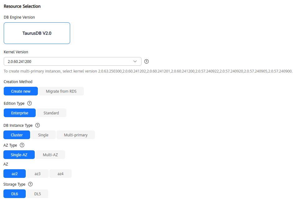

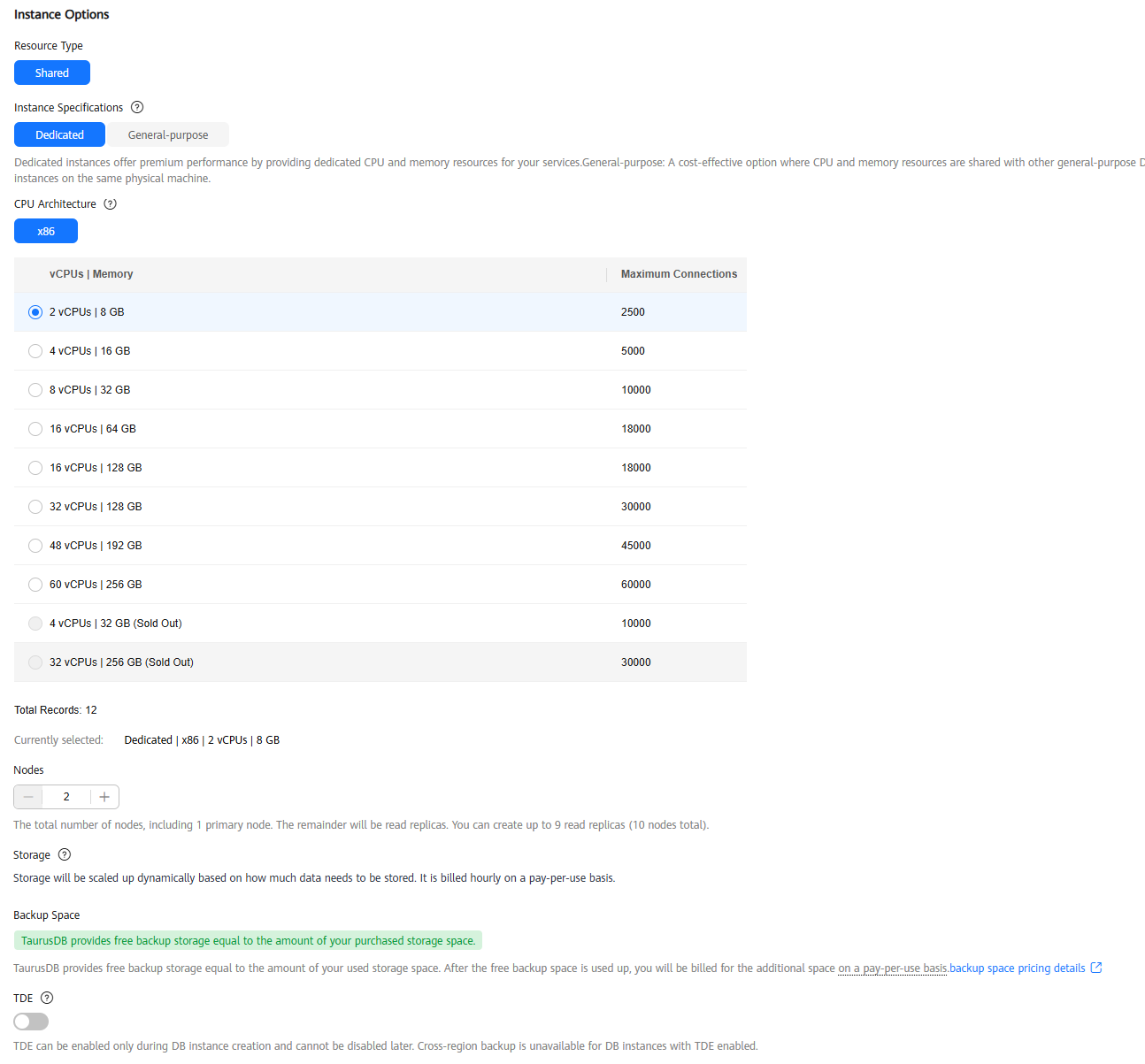

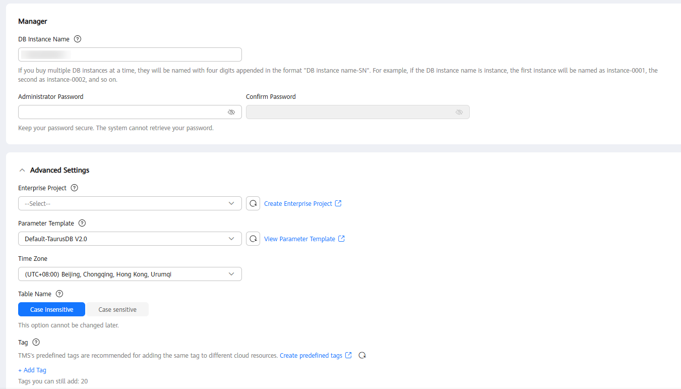

Step 1: Create a Database
- Log in to the TaurusDB console.
- Click
in the upper left corner and select a region. - On the Instances page, click the target instance name.
- In the navigation pane, choose Databases.
- Click Create Database. In the displayed dialog box, enter the database name principles and click OK.
