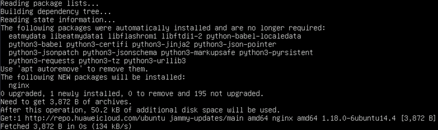

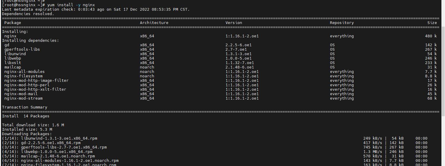

- Run the following command to install Nginx using Yum:
- For EulerOS, CentOS and Red Hat, or other OSs that support RPM installation, run the yum install -y nginx command.
- For OSs that support DEB installation, such as Ubuntu and Debian, run the apt install -y nginx command.
Figure 3 Installing Nginx (yum)
Figure 4 Installing Nginx (apt)

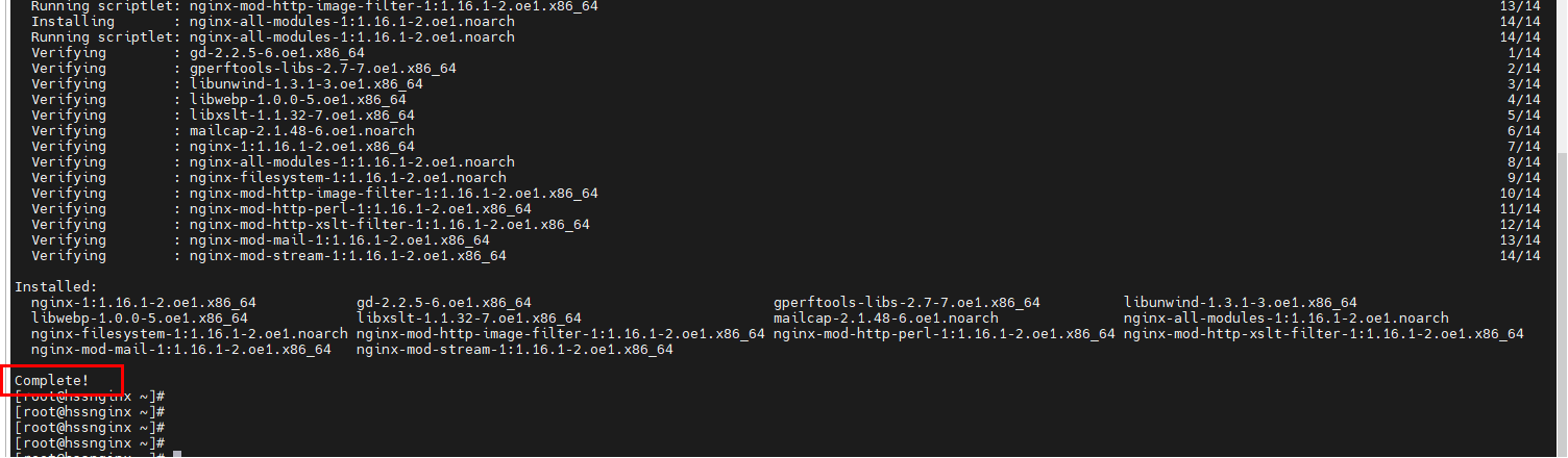

- For OSs that support RPM installation, such as EulerOS, CentOS, and Red Hat:
The installation is automatically performed. If Complete! shown in Nginx installed successfully (rpm) is displayed, the installation is successful.

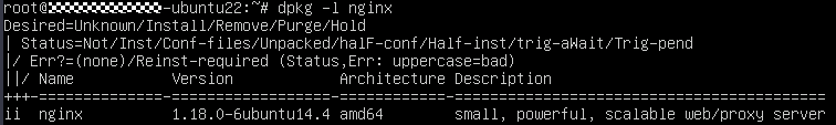

- For OSs that support DEB installation, such as Ubuntu and Debian:
Run the pkg –l nginx command. If the command output shown in Nginx installed successfully (deb) is displayed, the installation is successful.
