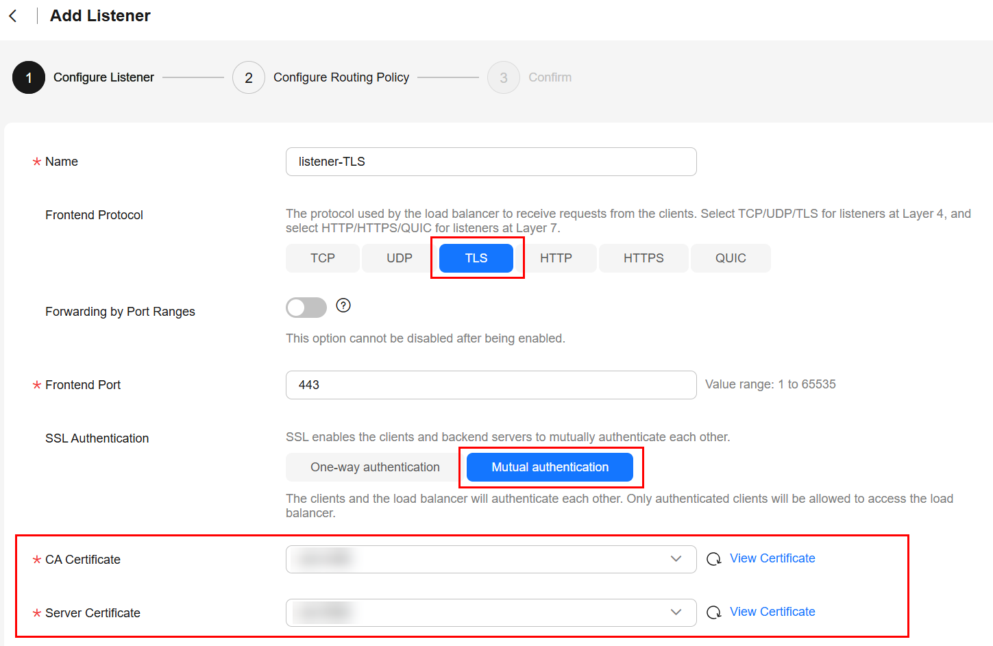

Step 3: Add a TLS Listener and Configure Mutual Authentication
- Go to the load balancer list page.
- Locate the target load balancer and click Add Listener in the Operation column.
- On the Add Listener page, select TLS for Frontend Protocol and Mutual authentication for SSL Authentication.
Select the server certificate uploaded to the ELB console in Step 1.
Select the CA certificate uploaded to the ELB console in Step 2.
Figure 2 Configuring mutual authentication
- Click Next: Configure Request Routing Policy and select Use existing for Backend Server Group. Select an existing backend server group and click Next: Confirm.
- Confirm the configurations and click Submit.

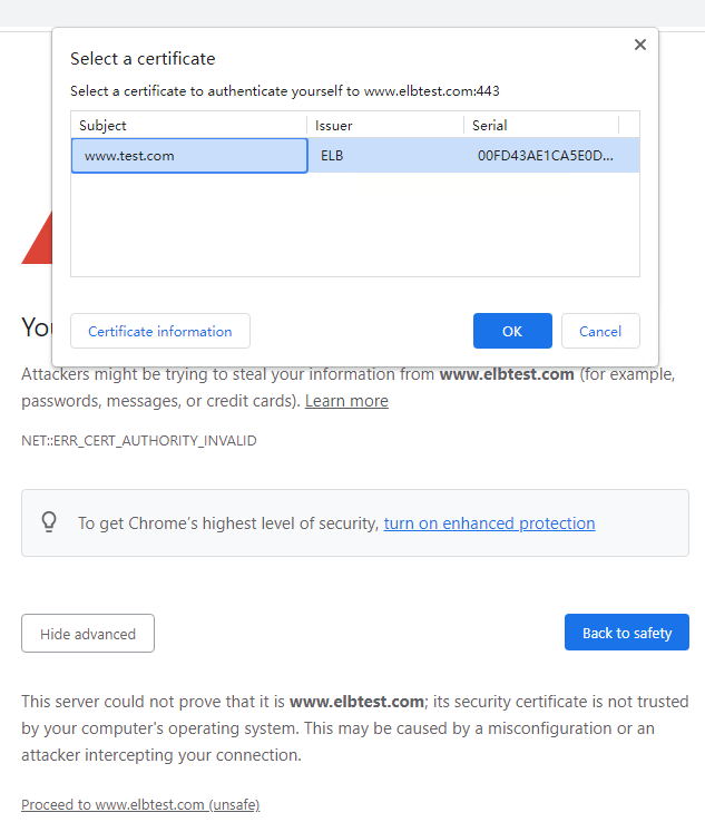

- Enter the domain name of the load balancer in the address box of the browser, for example, https://www.elbtest.com. In the displayed dialog box, select a certificate to authenticate yourself and click OK.
Figure 3 Selecting a certificate to authenticate yourself

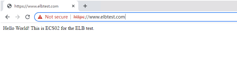

- Open the website in the incognito mode for accurate testing, because browser cache can cause clients to reuse existing TLS sessions. Refresh the page multiple times and you will see that requests are distributed across the two ECSs.
Figure 4 Requests forwarded to ECS01
Figure 5 Requests forwarded to ECS02
