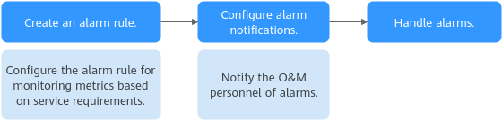

This section describes how you can use monitoring metrics to monitor ELB resources in basic service scenarios. You can adjust the monitoring thresholds as required, but keep them below the recommended values.
Procedure
Creating an Alarm Rule and Configuring Alarm Notifications
After an alarm rule is created, if a metric reaches the specified threshold or there is an event, Cloud Eye immediately informs you of the exception through SMN. The following describes how you can create an alarm rule and set notification rules.

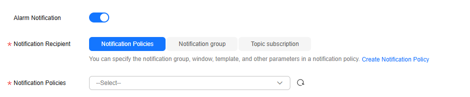

- Configure parameters for alarm notifications. Figure 2 Configuring an alarm notification
Table 3 Parameters for configuring an alarm notification Parameter
Description
Alarm Notifications
Whether to send notifications to users via SMS, email, voice notification, HTTP, HTTPS, FunctionGraph (function), FunctionGraph (workflow), WeCom chatbot, DingTalk chatbot, Lark chatbot, or WeLink chatbot.
Notified By
The following options are available:
- Notification groups: Configure notification templates on Cloud Eye.
- Topic subscriptions: Configure notification templates on SMN.
Notification Policies
This parameter is only available if you select Notification policies for Notified By. Select one or more notification policies. You can specify the notification group, window, template, and other parameters in a notification policy.
Notification Group
This parameter is only available if you select Notification groups for Notified By. Select the notification groups to which alarm notifications will be sent.
Recipient
This parameter is only available if you select Topic subscriptions for Notified By. You can select the account contact or a topic name as the object to which alarm notifications will be sent.
- Account contact is the mobile number and email address of the registered account.
- Topic is used to publish messages and subscribe to notifications. If the required topic is unavailable, create one first and add subscriptions to it. For details, see Creating a Topic and Adding Subscriptions.
Notification Template
This parameter is only available if you select Notification groups or Topic subscriptions for Notified By. You can select an existing template or create a new one.
Notification Window
Cloud Eye sends notifications only within the notification window you specified.
If Notification Window is set to 08:00-20:00, Cloud Eye sends notifications only within this window.
Trigger Condition
You can select either Generated alarm or Cleared alarm, or both.
