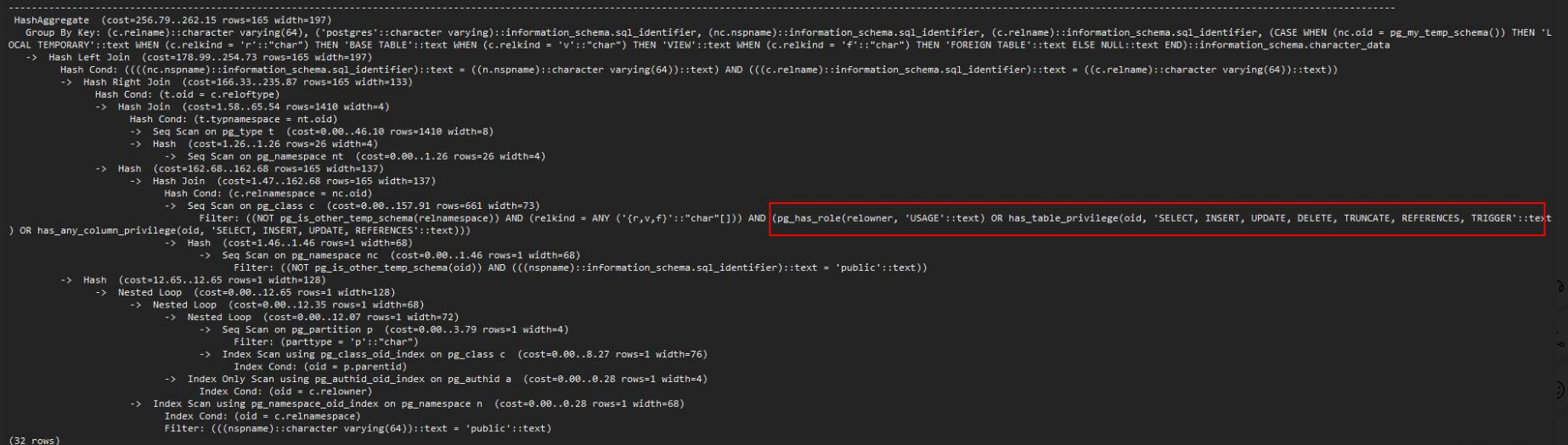

Part of the execution plan is as follows:
In the system view, the OR condition is used for permission check.
pg_has_role(c.relowner, 'USAGE'::text) OR has_table_privilege(c.oid, 'SELECT, INSERT, UPDATE, DELETE, TRUNCATE, REFERENCES, TRIGGER'::text) OR has_any_column_privilege(c.oid, 'SELECT, INSERT, UPDATE, REFERENCES'::text) |
true is always returned for pg_has_role of the dbadmin use. Therefore, the conditions after OR do not need to be checked.
However, the OR condition of common users needs to be checked one by one. If there are a large number of tables in the database, the execution time of common users is longer than that of dbadmin.
In this scenario, if the number of output result sets is small, you can set set enable_hashjoin and set enable_seqscan to off, to use the index+nestloop plan.
