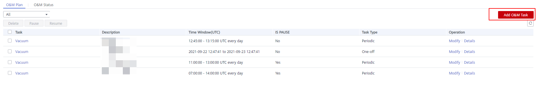

- Click the O&M Plan tab. Click Add O&M Task.
- The Add O&M Task page is displayed.

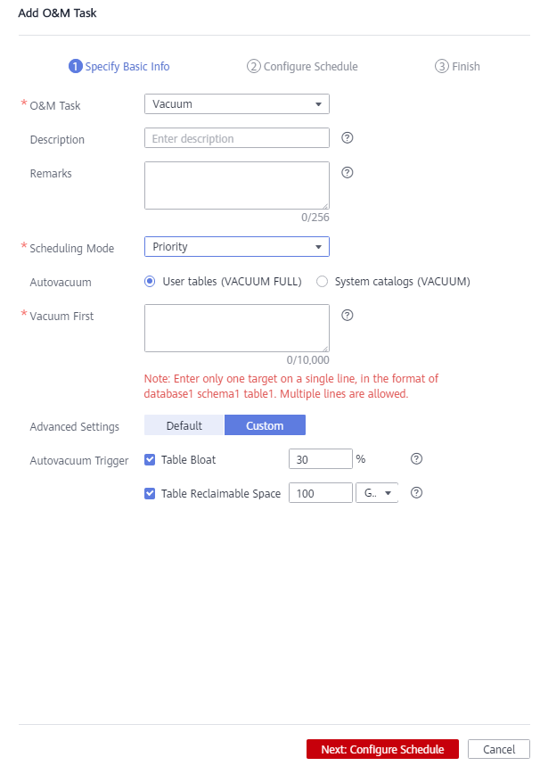

- Select Vacuum for O&M Task.
- Set Scheduling Mode to Auto. DWS automatically scans tables that require VACUUM operation.
- Select System catalogs or User tables for Autovacuum.
- If there are a large number of UPDATE and DELETE operations, select the User tables.
- If there are a large number of CREATE and DELETE operations, select System catalogs.

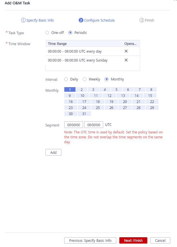

- Click Next: Configure Schedule to configure the schedule and Vacuum type. You are advised to select Periodic for Task Type. The DWS automatically executes VACUUM in your selected time windows.
For automatic Vacuum O&M tasks, the system uses the VACUUM FULL operation to process user tables. VACUUM FULL holds a level 8 lock, which blocks other transactions. Other transactions will be in lock waiting during VACUUM FULL execution. After 20 minutes, a timeout error is reported. Therefore, do not perform other transactions in the configured time window.
