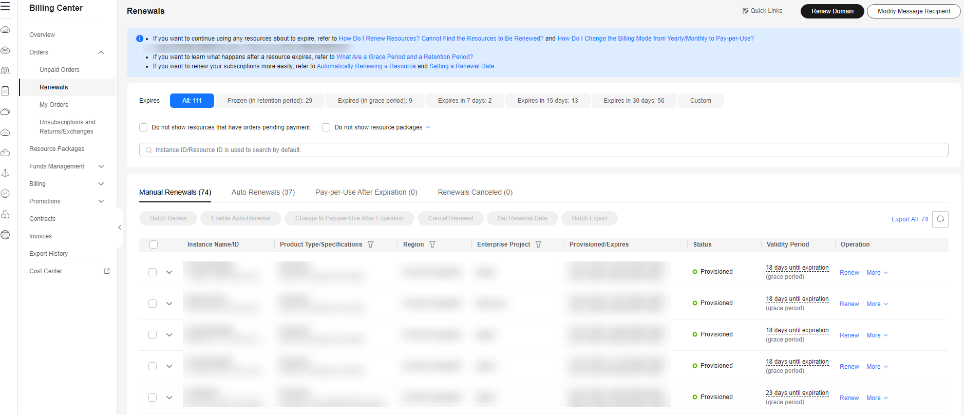

- Hover over Billing in the upper part of the console and choose Renewal from the drop-down list. The Renewals page is displayed.
- Customize search criteria, as shown in Figure 1.
- Under the Pay-per-Use After Expiration tab, you can check the resources that have already been set to change to pay-per-use billing upon expiration.
- Under the Manual Renewals, Auto Renewals, and Renewals Canceled tabs, you can change the resources to pay-per-use billing upon expiration.

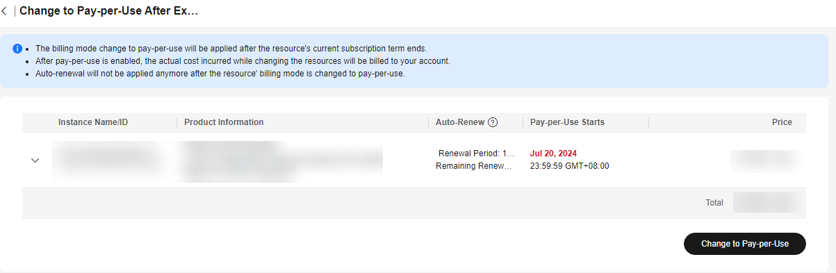

- Change yearly/monthly desktops to pay-per-use billing upon expiration, as shown in Figure 2.

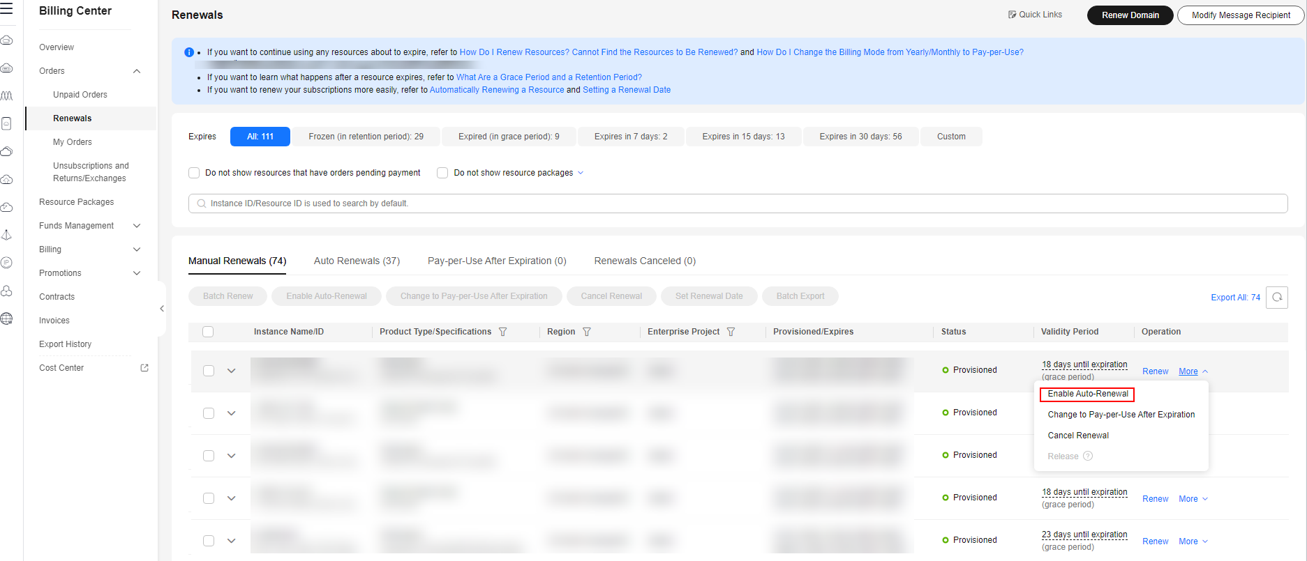

- For one desktop: Select the desktop for which you want to change the billing mode, and choose More > Change to Pay-per-Use After Expiration in the Operation column.
- For multiple desktops: Select the desktops for which you want to change the billing mode, and click Change to Pay-per-Use After Expiration above the resource list, as shown in Figure 3.

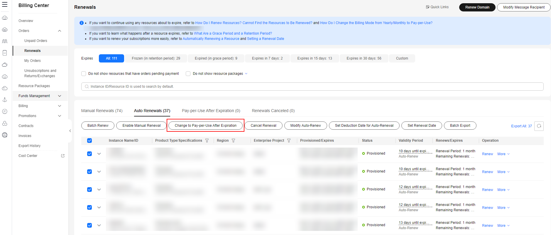

- Confirm the subscription change details, and click Change to Pay-per-Use After Expiration, as shown in Figure 4.
