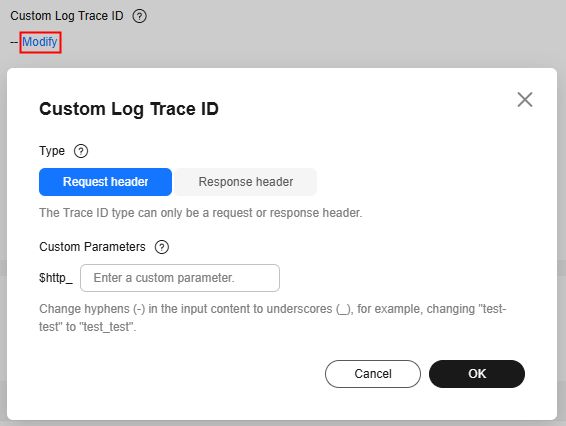

- In the Advanced Settings area, click Modify under Custom Log Trace ID, specify Type, and configure Custom Parameters.
Figure 1 Custom Log Trace ID
