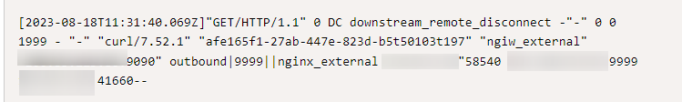

DC
Description
DC (DownstreamConnectionTermination) indicates that the downstream connection is terminated.
If the client disconnects from the server before receiving a response due to various reasons, DC will be recorded in the access logs. In most cases, the size of the response body is 0.
Typical Symptom
When accessing the target service, the client disconnects from the server before receiving a response or receives no response from the server within the timeout set on the client.
Example Log
Client log
Suggestion
Generally, no operation is required. In most cases, time-consuming responses often result in client disconnections. You can optimize the target service to solve such an issue.

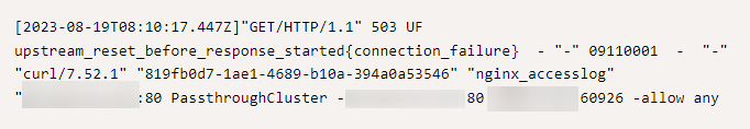

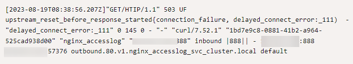

UF
Description
UF (UpstreamConnectionFailure) indicates an upstream connection error.
Typical Symptom
The service port of the target service is unreachable. For example, if the client accesses the target service over an invalid port, 503UF will be recorded in the outbound logs of the client agent.
If the pod port of the target service is unreachable, 503UF will be recorded in the inbound log of the server.
Example Logs
Outbound log generated for an invalid service port
Inbound log generated for an invalid pod port
Suggestion
Specify a valid service port, so that the client accesses the target service over this port.

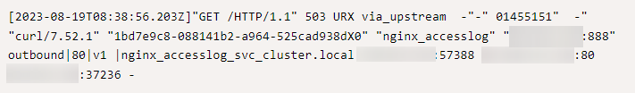

URX
Description
URX (UpstreamRetryLimitExceeded) indicates that the requests are rejected because the HTTP retry limit or the maximum number of TCP connection attempts is reached.
Typical Symptom
If the number of failures to invoke the server reaches the retry limit configured for the target service in the service mesh, or the failure persists after two retries (default value in Istio), URX will be recorded in the outbound logs on the client.
Example Log
Outbound log on the client
Suggestion
Improve the service success rate, so that services can be properly accessed after limited retries.

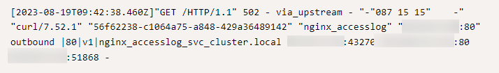

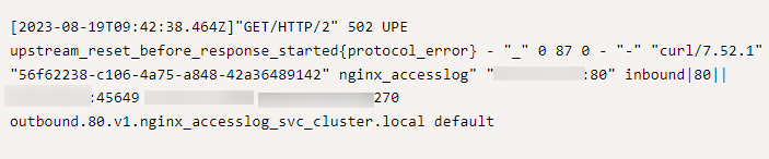

UPE
Description
UPE (UpstreamProtocolError) indicates an upstream protocol error.
Typical Symptom
If an application protocol defined for each service port in the service mesh is inconsistent with the actual protocol, the client will receive protocol error code 502 during service access. 502 UPE will be recorded in the inbound logs on the server.
Example Logs
Inbound log on the server
Suggestion
Define a correct application protocol for each service port. Ensure that the protocol is read from the port name of the service in Istio, or use the AppProtocol field to specify a correct application protocol for each service port.

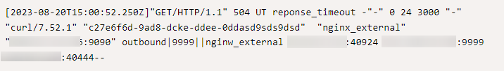

UT
Description
UT (UpstreamRequestTimeout) indicates that an upstream request times out. Generally, HTTP status code 504 is returned.
Typical Symptom
A timeout is configured for the target service in VirtualService. When the specified time period expires, the client agent automatically times out and cancels the request.
Example Log
Suggestion
No operation is required. The timeout is configured for quick access failure of the target service. If the service access times out, the response flag will be returned.
