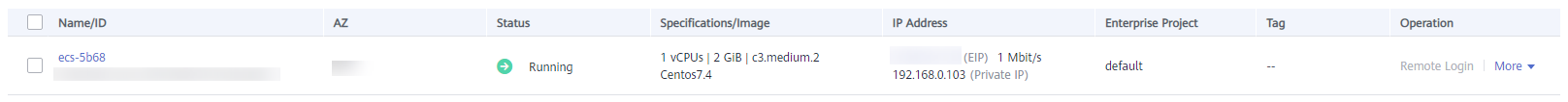

  1. Log in to the management console and check whether there is an ECS available.
    • If there is a Linux ECS, go to 3.
    • If no Linux ECS is available, go to 2.
    Figure 1 ECS
  2. Buy an ECS and select Linux (for example, CentOS) as its OS.

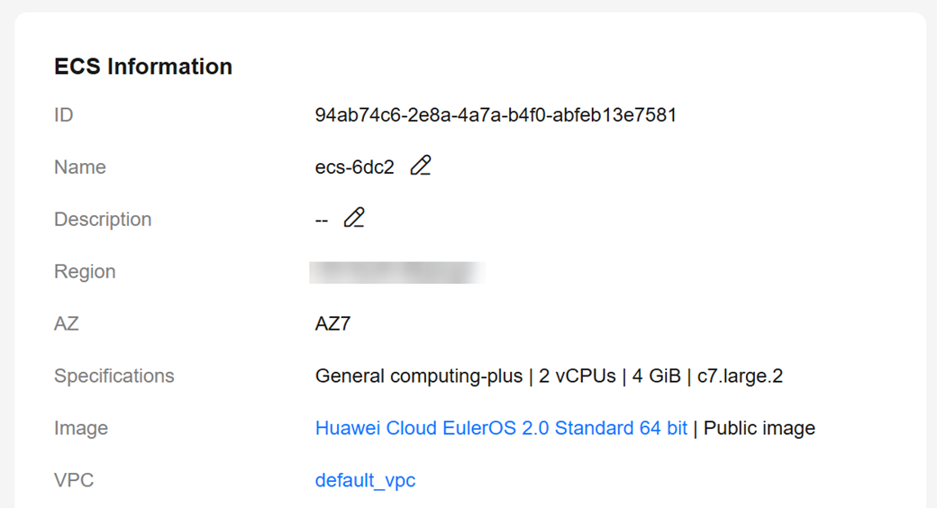

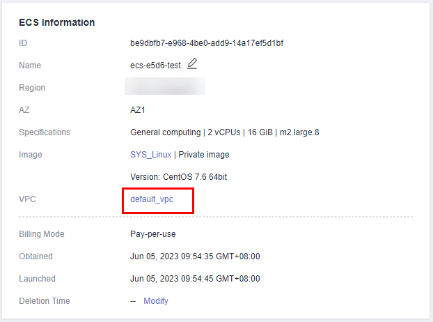

  3. On the ECS Information page, check the region and VPC of the ECS.
    Figure 2 ECS information

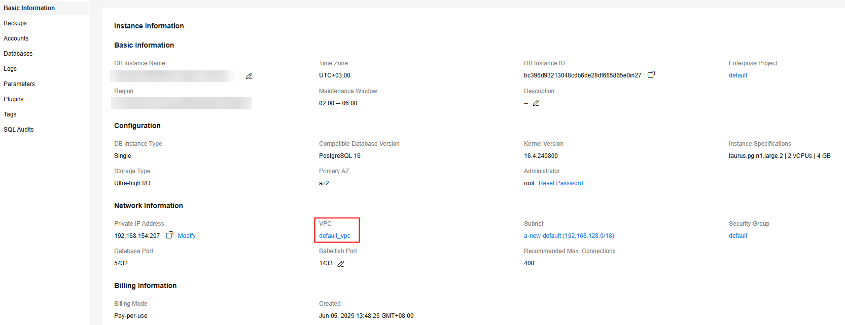

  4. On the Basic Information page of the TaurusDB for PostgreSQL instance, check the region and VPC of the instance.
    Figure 3 Checking the region and VPC
  5. Check whether the ECS and the TaurusDB for PostgreSQL instance are in the same region and VPC.
    • If they are in the same region and VPC, go to Step 2: Test Connectivity and Install the PostgreSQL Client.
    • If they are not in the same region, purchase another ECS or DB instance. The ECS and DB instance in different regions cannot communicate with each other. To reduce network latency, deploy your DB instance in the region nearest to your workloads.
    • If the ECS and DB instance are in different VPCs, change the VPC of the ECS to that of the DB instance. For details, see Changing a VPC.

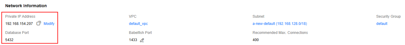

  2. On the Instances page of the TaurusDB console, click the instance name to go to the Basic Information page.
  3. In the Network Information area, obtain the private IP address and database port of the DB instance.
    Figure 4 Obtaining the private IP address and database port

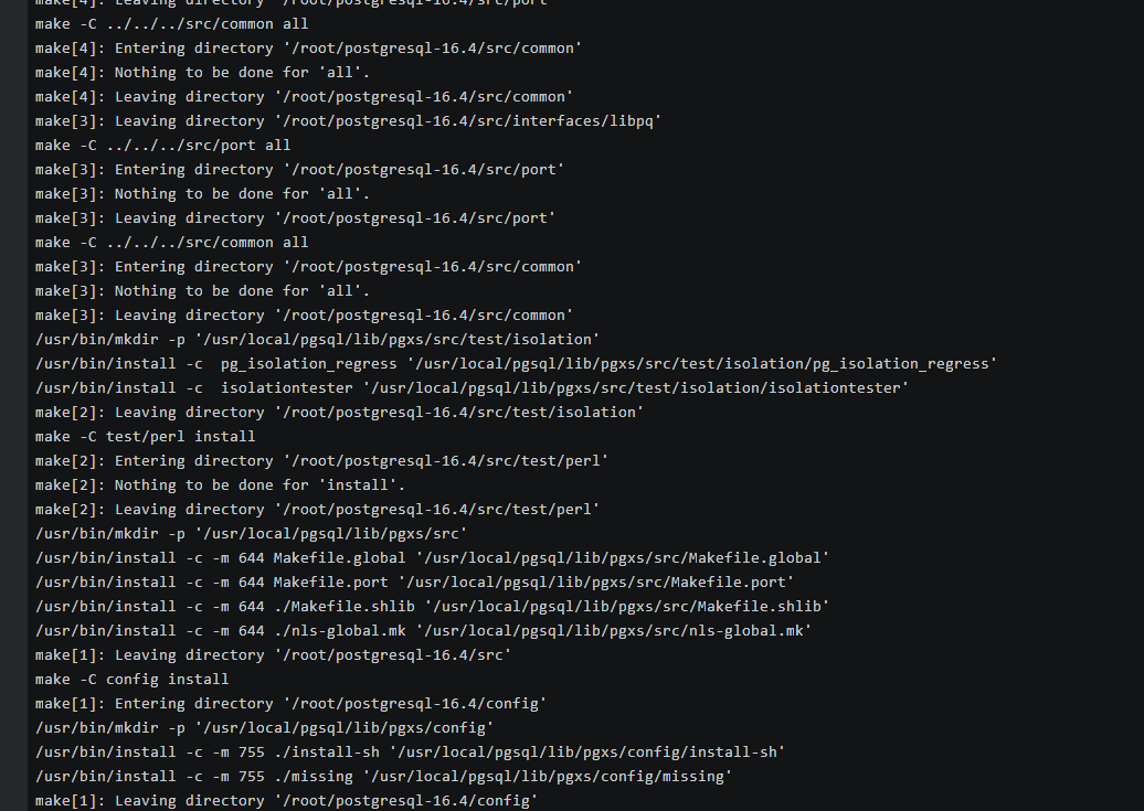

    4. Compile the source code and then install the client.
      cd postgresql-16.4
      ./configure --without-icu --without-readline --without-zlib --with-openssl
      make -j 8 && make install
      If --prefix is not specified, the default path is /usr/local/pgsql. The client can be installed in the simplest way.
      Figure 6 Compilation and installation

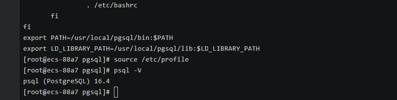

    6. Test whether the psql is available.
      psql -V
      Figure 7 Testing psql
