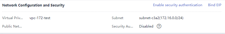

  1. In the Network Configuration and Security area, click Bind EIP.
  2. Read the security risk prompt in the displayed dialog box and select I understand the security risks.
  3. In the EIP drop-down list, select the EIP to be bound. You can only select an EIP in the same enterprise project as the microservice engine.
  4. Click OK.

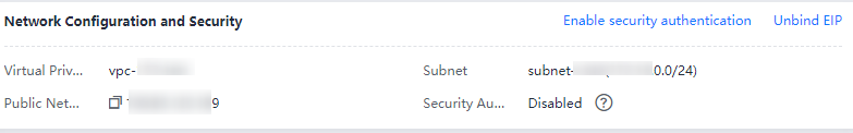

  1. In the Network Configuration and Security area, click Unbind EIP.
  2. In the displayed dialog box, click OK.
