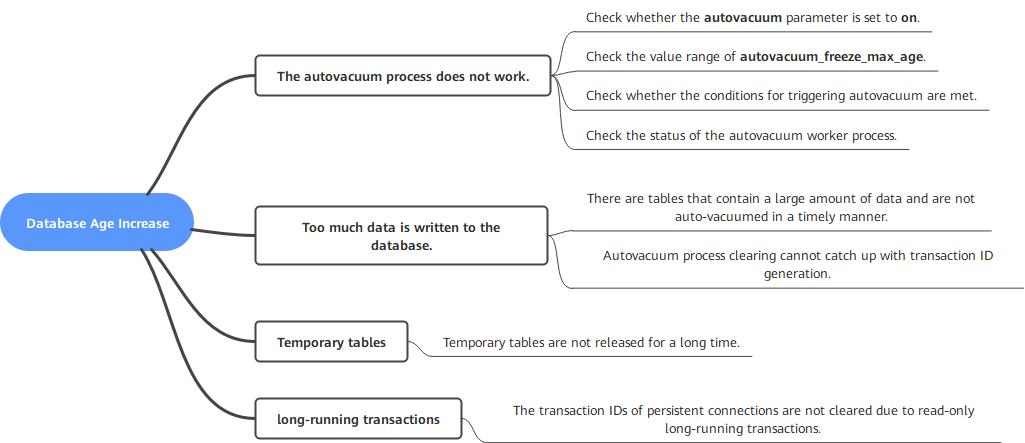

Troubleshooting Process
There are several possible causes:
  1. The autovacuum process does not work.
  2. Too much data is written to the database.
  3. Temporary tables are not released for a long time.
  4. There are read-only long-running transactions.
Figure 1 Troubleshooting process

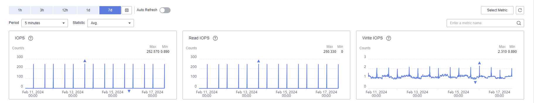

      If autovacuum is running properly, check the disk read/write throughput and IOPS metrics for the last seven days. If the storage remains full for an extended period, the high disk I/O prevents the autovacuum process from keeping up with transaction ID generation, causing the database age to increase.
      For details about the storage types and maximum throughput, see Performance Comparison of DB Instance Storage Types.
      Figure 2 Viewing disk read/write throughput
      Figure 3 Viewing IOPS

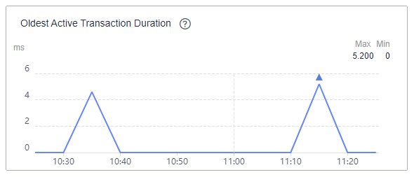

    2. Alternatively, check the oldest active transaction duration on the Cloud Eye console and determine whether there are long-running transactions.
      You can only determine whether there are long-running transactions, but cannot view details about the long-running transactions on the Cloud Eye console. You are advised to use both SQL statements and Cloud Eye to identify long-running transactions.
      Figure 4 Viewing the oldest active transaction duration
