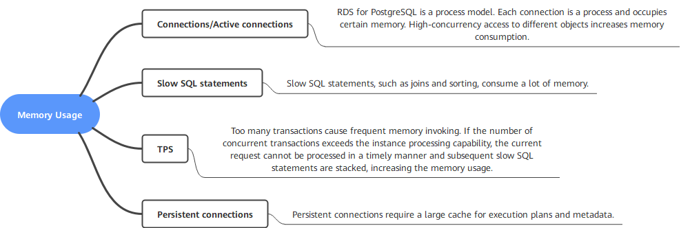

Possible Causes
Figure 1 shows the troubleshooting process for memory overload.
- Connections/Active Connections
- On the monitoring page of the console, check whether the memory usage, connection usage, number of database connections, and number of active connections increase or decrease simultaneously in the target period.
- Run the following SQL statement as root to check the maximum number of connections allowed for the instance:
show max_connections;
- Run the following SQL statement as root to check the number of active connections to the instance:
select count(1) from pg_stat_activity where state <> 'idle';
- Run the following SQL statement as root to check the number of idle connections:
select count(1) from pg_stat_activity where state = 'idle';
- Slow SQL Statements
- On the monitoring page of the console, check whether the memory usage, number of SQL statements executed for more than 1s, number of SQL statements executed for more than 3s, and number of SQL statements executed for more than 5s increase or decrease simultaneously in the target period.
- Run the following SQL statement to view the top three slow SQL statements (for RDS for PostgreSQL 10 and later versions) and check whether the SQL statements in the returned query field use the JOIN or ORDER syntax:
select (extract(epoch from now() - query_start)) query_time, datname, usename, client_addr, wait_event, state, query from pg_stat_activity where state not like 'idle%' and query_start is not null and backend_type = 'client backend' and pid <> pg_backend_pid() order by 1 desc limit 3;
- Query the pg_stat_statements view to obtain statistics and find the SQL statements that consume the most shared memory. For details, see 4.
- TPS
On the Cloud Eye console, check whether the memory usage and TPS increase or decrease simultaneously in the target period.
- Persistent Connections
- Run the SQL statement shown below to view the top three persistent connections (for RDS for PostgreSQL 10 and later versions). In the command output, the conn_time field indicates the connection lifetime, and the query field indicates the SQL statement executed by the process.
select (extract(epoch from now()-backend_start)) conn_time, datname, pid, usename, client_addr, wait_event_type, wait_event, state, query from pg_stat_activity where backend_type = 'client backend' order by conn_time desc nulls last limit 3;
- Persistent connections cache certain information, such as query results, transaction information, and lock information, in the database. If many persistent connections are maintained for a long period of time, the cached information increases accordingly, occupying more memory. To further locate the fault, query the pg_stat_statements view based on the value of the query field obtained in the last step and check how much shared memory the SQL statement has used.
select userid::regrole, dbid, shared_blks_hit, shared_blks_dirtied from pg_stat_statements where query = 'query';
If there are too many connections or idle connections, run the SQL statement shown below as root or configure connection timeout for clients to release idle connections, or use a connection pool to reduce the overhead of establishing new database connections. If there are too many active connections, reduce the number of concurrent requests or upgrade the memory specifications. You can also terminate unnecessary sessions to reduce memory consumption. For details, see Managing Real-Time Sessions.
Killing a session may cause the application to disconnect from the instance. Your application should be able to reconnect to the instance.
select pg_terminate_backend(pid) from pg_stat_activity where state = 'idle';
- Too Many Slow SQL Statements
Locate the SQL statements that consume much memory, optimize the SQL statements or upgrade the memory specifications.
- High TPS
Reduce the number of transactions or upgrade the memory specifications.
- Too Many Persistent Connections/Long Connection Lifetime
Periodically release persistent connections because maintaining them may generate a large cache and use up memory.
