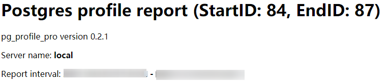

  • Title
    The title contains start and end sample IDs, pg_profile_pro kernel version, server name, and report interval.
    Figure 1 Report title

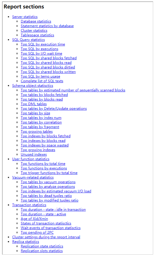

  • Contents
    Each layer of contents is linked to a table. You can get an overview of all tables from the contents or click the links to view each table.
    The following figure shows an example.
  • Tables
    The reports present database performance across multiple dimensions and areas of focus.
    • Each table is followed by suggestions on the focuses.
    • In each table, you can move the mouse pointer to a column title to view the comments (both in Chinese and English).
