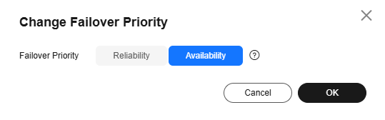

- On the displayed Summary page, find Failover Priority and click Configure under it. In the displayed dialog box, select a priority and click OK. Figure 1 Changing the failover priority
