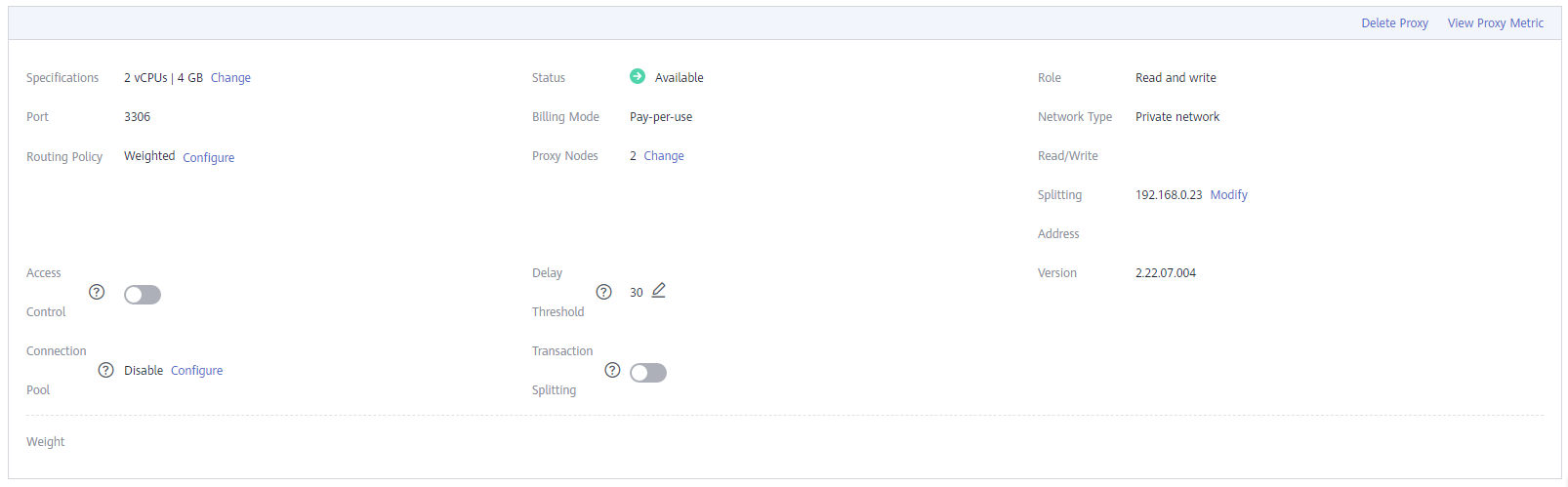

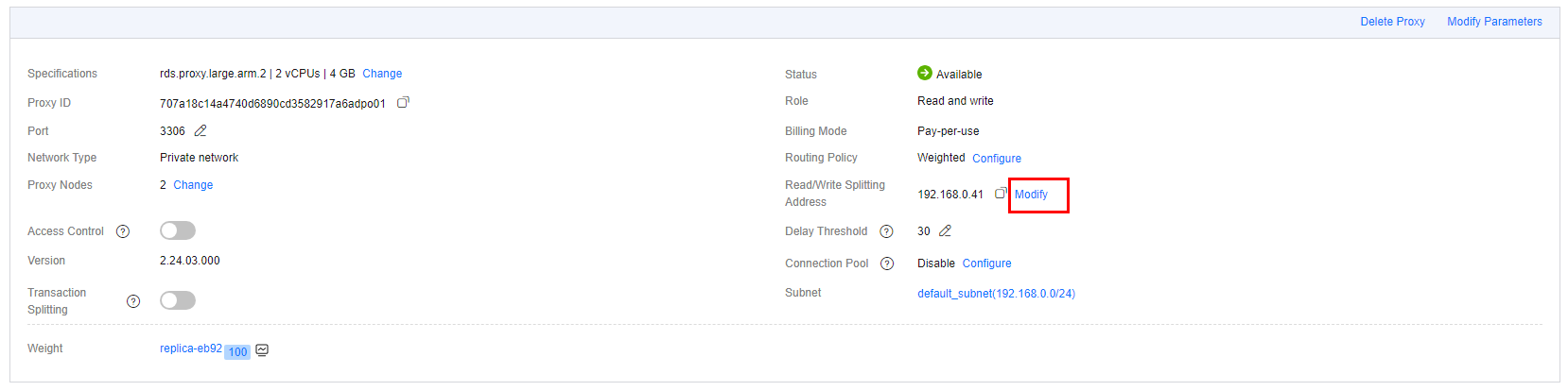

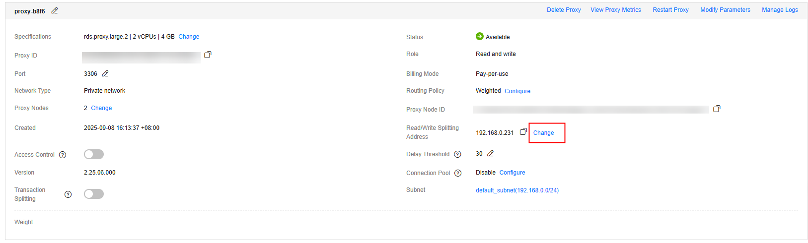

- Click Database Proxy in the navigation pane on the left. On the displayed page, click Modify next to the Read/Write Splitting Address field.
Figure 1 Read/write splitting area (single-proxy)Figure 2 Read/write splitting area (multi-proxy)

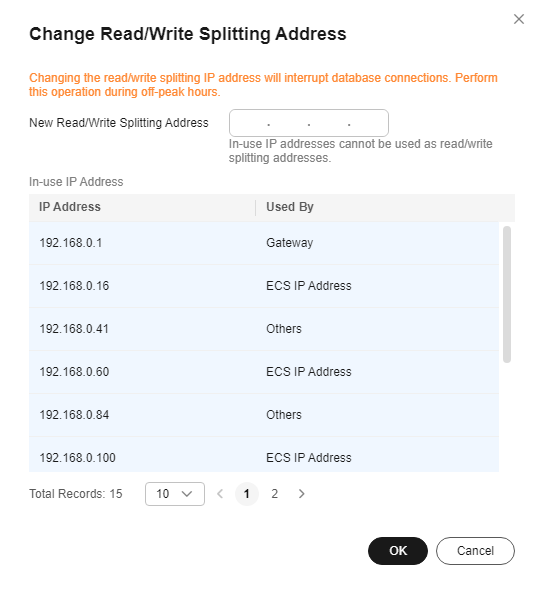

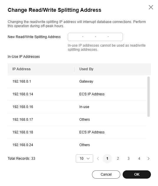

- In the displayed dialog box, enter a new address. Click OK.
In-use IP addresses cannot be used as read/write splitting addresses.
Figure 3 Changing the read/write splitting address
