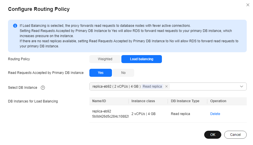

- If proxy load balancing is enabled, click Configure next to the Routing Policy field in the proxy information area. In the displayed dialog box, set required parameters.
Select Load balancing as the routing policy. Read requests will be automatically distributed to read replicas based on the number of active connections to balance the load among these read replicas.
Figure 2 Routing policy - Load balancingRead Requests Accepted by Primary DB Instance:- Yes: Read requests can be routed to both the primary instance and read replicas, which increases the load of the primary instance. Configure this parameter as required.
- No: To offload read pressure from the primary instance, read requests are only routed to read replicas.
- Click OK. On the Database Proxy page, view the result. You can select the instances for load balancing as required.

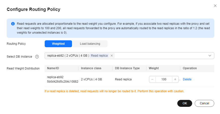

- In the proxy information area, click Configure next to the Routing Policy field. In the displayed dialog box, set required parameters.
- Weighted: You can distribute read weights for the DB instance and read replicas. For details, see Table 1.
The system automatically distributes weights to read replicas, including read replicas created afterwards, according to the default distribution rules. If a read replica breaks down or is deleted, the weight is automatically removed. After the read replica recovers, the weight is automatically restored.
Forcible routing is also supported. For details, see Adding a Hint to Specify the Direction that a SQL Statement Will Be Routed.

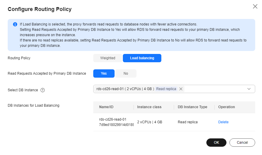

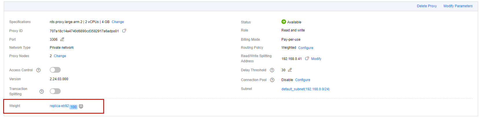

Figure 3 WeightedClick OK and view the weights in the proxy information area.Figure 4 Viewing weights - Load balancing: If selected, to balance the load among read replicas, read requests are automatically distributed to multiple read replicas based on the number of active connections.
Figure 5 Load balancing
In the Select DB Instance drop-down list, select the instances for load balancing.
To add new read replicas for load balancing, select the read replicas from the Select DB Instance drop-down list and click OK.

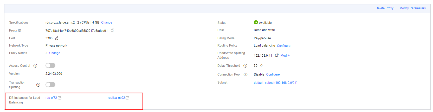

Click OK and view DB instances for load balancing in the proxy information area.Figure 6 Viewing DB instances for load balancing
