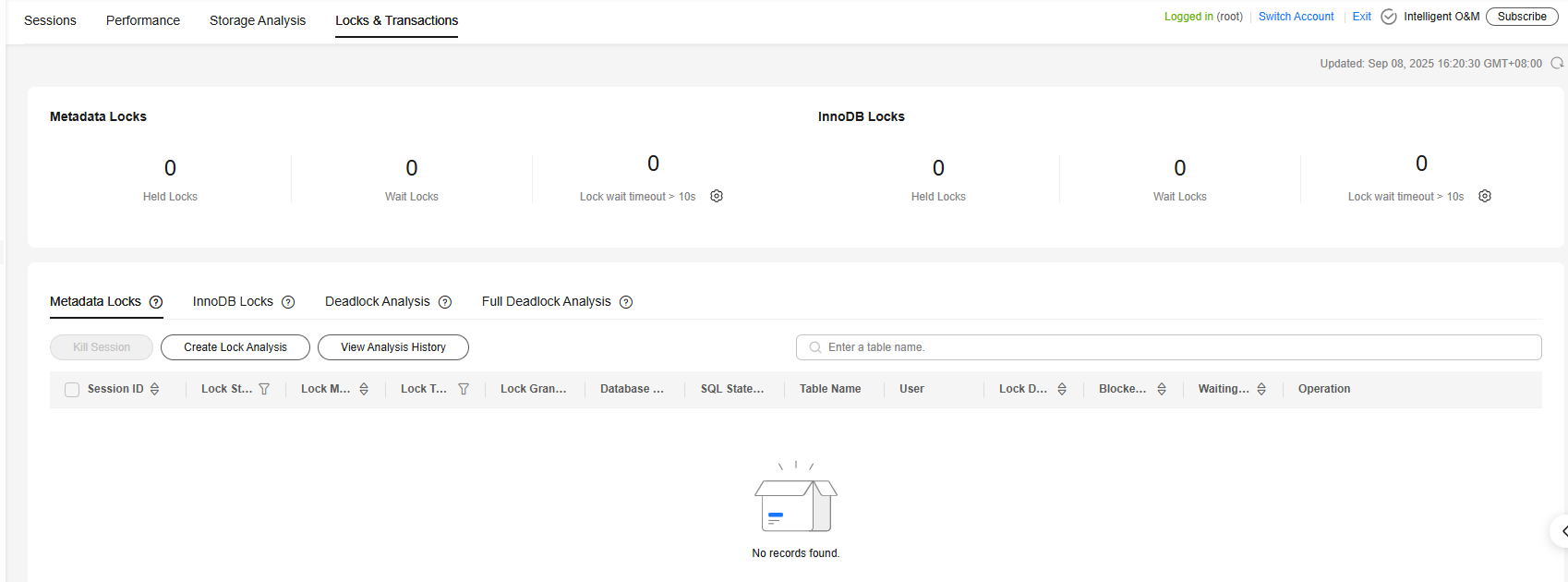

Metadata Locks
- Metadata locks (MDLs) are used to ensure consistency between DDL and DML operations. DDL operations generally need to acquire an MDL write lock. Once an MDL lock wait occurs, it can affect database performance because any subsequent SELECT, DML, or DDL operations on the table will be blocked, causing a connection backlog.
- Metadata locks are displayed in real time. You can quickly identify problems and terminate the sessions with metadata locks to restore blocked operations.
- DML locks are not included. You can view and analyze them on the InnoDB Locks page.
- A maximum of 1,000 records can be displayed.

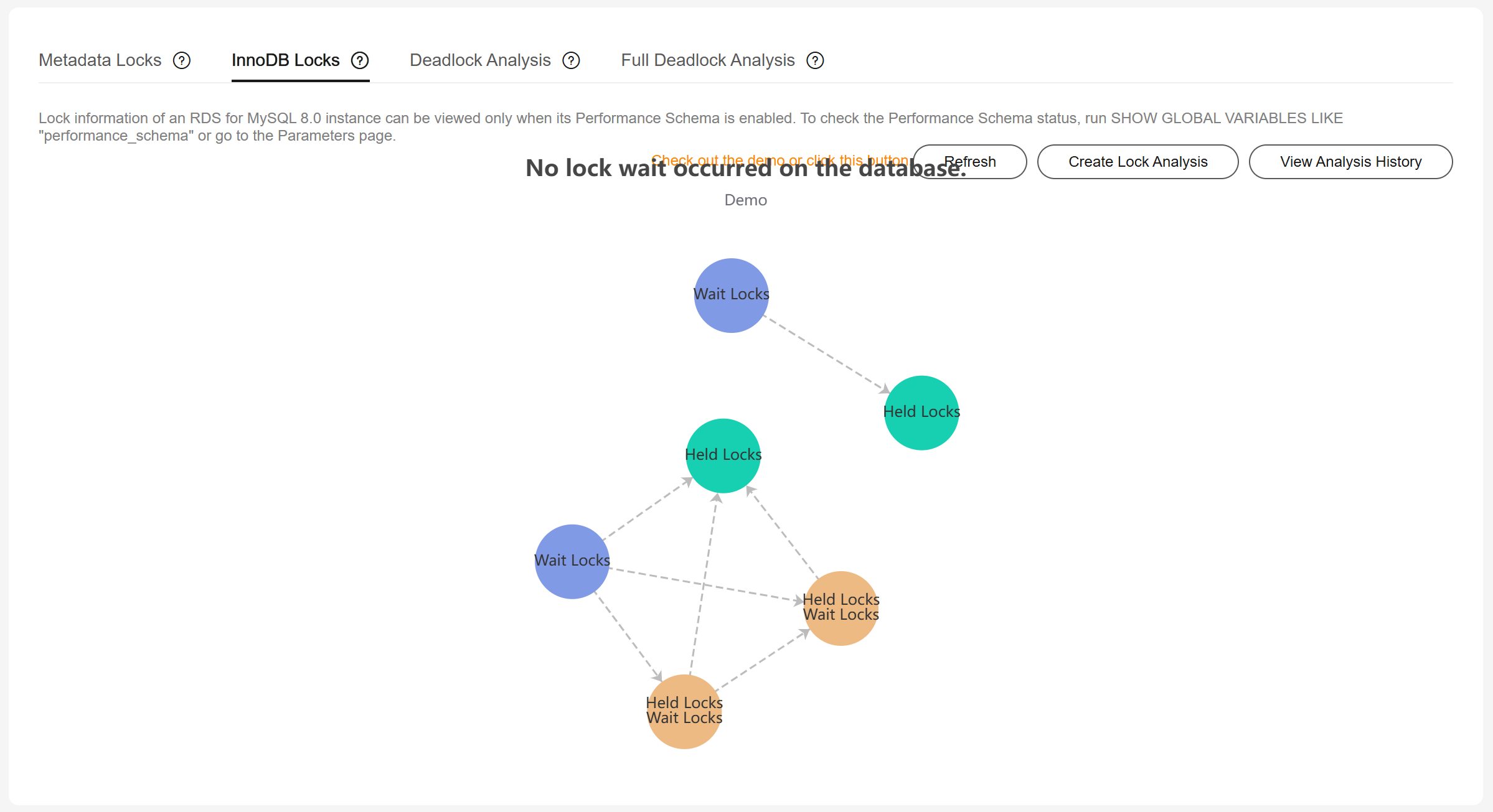

InnoDB Locks
- InnoDB lock waits generated before DML operations are displayed in real time. You can quickly locate the session waits and any blocks that happened when multiple sessions update the same piece of data at the same time, and can terminate the source session that holds locks to restore blocked operations.
- DDL locks, also called metadata locks, are not included. You can view and analyze them on the Metadata Locks page.

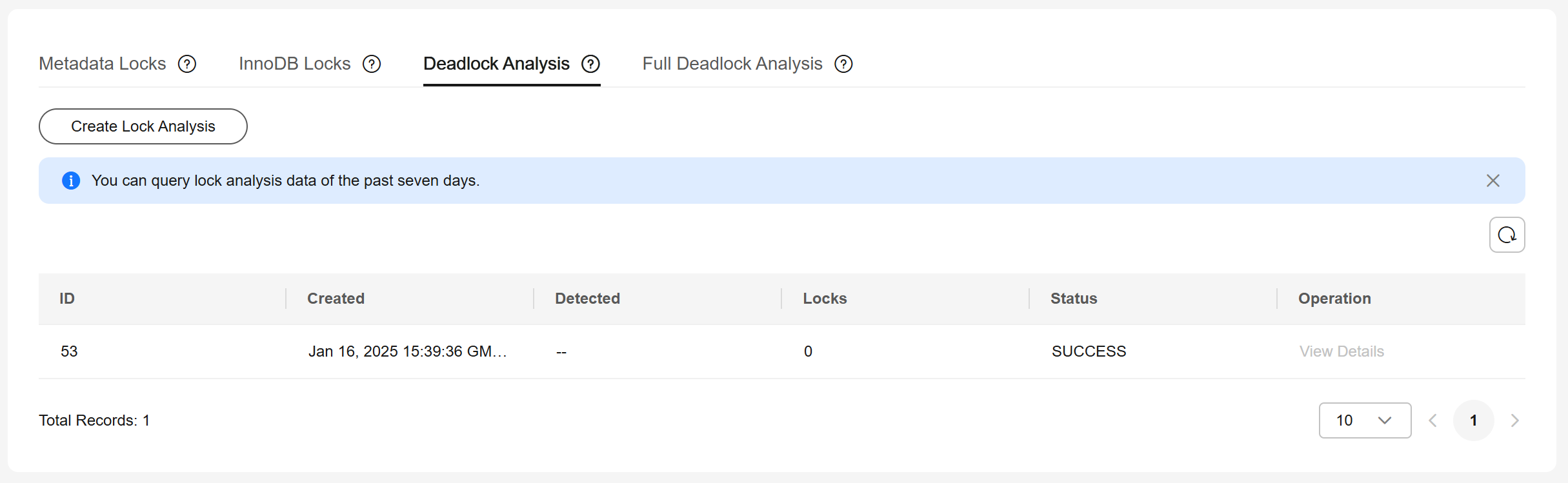

Deadlock Analysis
- DBA Assistant analyzes the latest deadlock log returned by SHOW ENGINE INNODB STATUS. If there are multiple deadlocks, only the latest one is analyzed.

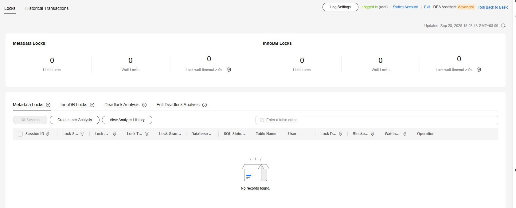

- On the Locks tab page, perform the following operations:
- Click the Metadata Locks tab, create a lock analysis task and check whether the instance has metadata locks. By default, locks whose wait time is longer than 10s are displayed, but you can change this time if needed.Figure 1 Metadata Locks
- Click the InnoDB Locks tab, create a lock analysis task and check whether the instance has InnoDB locks. By default, locks whose wait time is longer than 10s are displayed, but you can change this time if needed.Figure 2 InnoDB Locks
- Click the Deadlock Analysis tab and create a lock analysis task. DBA Assistant analyzes the latest deadlock log returned by SHOW ENGINE INNODB STATUS. If there are multiple deadlocks, only the latest one is analyzed. You can only query lock analysis data of the past seven days.Figure 3 Deadlock Analysis
