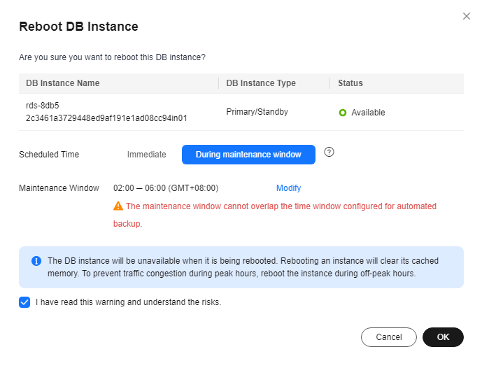

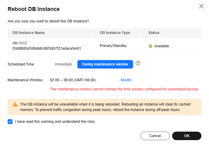

  4. In the displayed dialog box, select a scheduled time, select the check box, and click OK.
    • Immediate: RDS reboots the instance immediately.
    • During maintenance window: RDS will reboot the instance during the maintenance window you configured.
      If you select During maintenance window, you can further click Modify under the option to change the maintenance window to a preferred time.
      Figure 1 Rebooting an instance as scheduled
