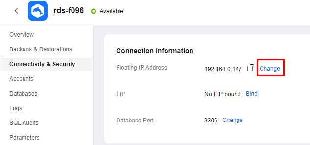

- Under Floating IP Address, click Configure.
Alternatively, in the navigation pane on the left, choose Connectivity & Security. In the Connection Information area, click Change next to the Floating IP Address field.
Figure 1 Floating IP address

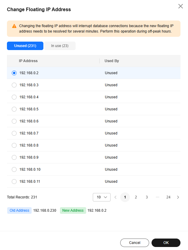

- In the displayed dialog box, check the number of in-use IP addresses. If the in-use IP addresses are less than 254, there are unused floating IP addresses.
Figure 2 Changing a floating IP address
- Select an available IP address and click OK.
An in-use IP address cannot be used as the new floating IP address of the DB instance.
