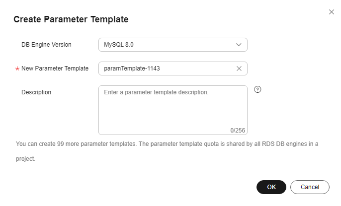

- On the Parameter Templates page, click Create Parameter Template.
- In the displayed dialog box, configure required information and click OK.
- Select a DB engine for the parameter template.
- Enter a template name that consists of 1 to 64 characters. It can contain only letters (case-sensitive), digits, hyphens (-), underscores (_), and periods (.). Avoid starting the name with Default.
- Enter a description that consists of no more than 256 characters. The description cannot contain carriage return characters or the following special characters: >!<"&'= Figure 1 Creating a parameter template
