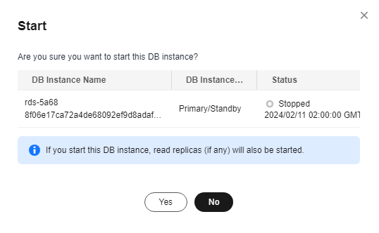

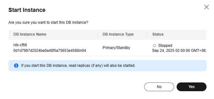

- Click
in the upper left corner and select a region. - Click
in the upper left corner of the page and choose Databases > Relational Database Service. - On the Instances page, locate the primary instance that you want to start and choose in the Operation column.
- In the displayed dialog box, click Yes.
Figure 1 Starting an instance
- If you have enabled operation protection, click Send Code in the displayed Identity Verification dialog box and enter the obtained verification code. Then, click OK.
