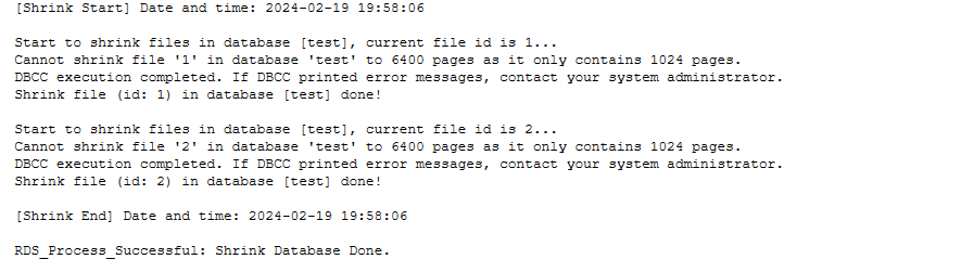

  1. Run the following command to shrink the dbtest2 database:
    EXEC [master].[dbo].[rds_shrink_database] @DBName = 'test';
    The command output is as follows.
