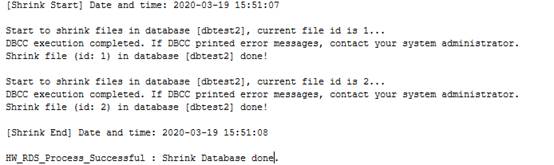

The following figure shows the execution result set. Each result corresponds to the information about each file in the specified database (or all databases).
Figure 1 Result set

- After the command is successfully executed, the following information is displayed:
HW_RDS_Process_Successful: Shrink Database Done.
