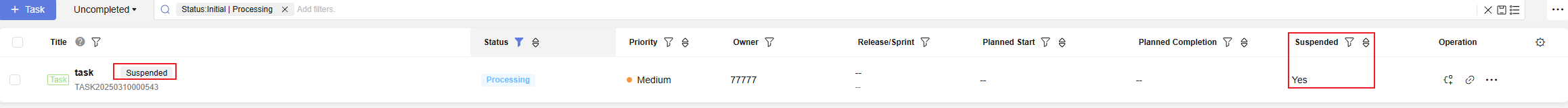

    2. Edit the status information. Suspend/Cancel is disabled by default.
      Take the Analyzing status as an example. If you enable the Suspend/Cancel switch, when an RR enters the Analyzing status, you can click Suspend in the upper right corner of the details page and enter the suspension reason. Then, the requirement enters the Suspended status and is marked as suspended in the requirement list.
      You can unsuspend requirements. Once you unsuspend a requirement, the suspension flag on the requirement name disappears. Click Cancel Suspension in the upper right corner of the details page to continue the process.

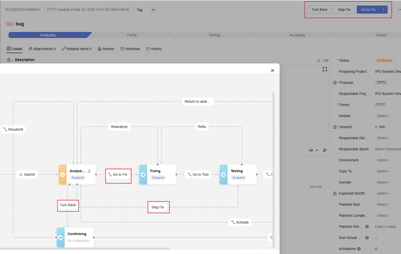

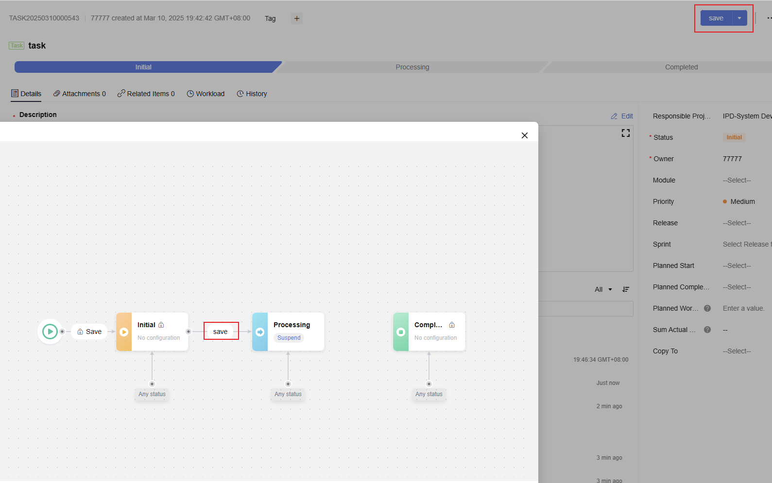

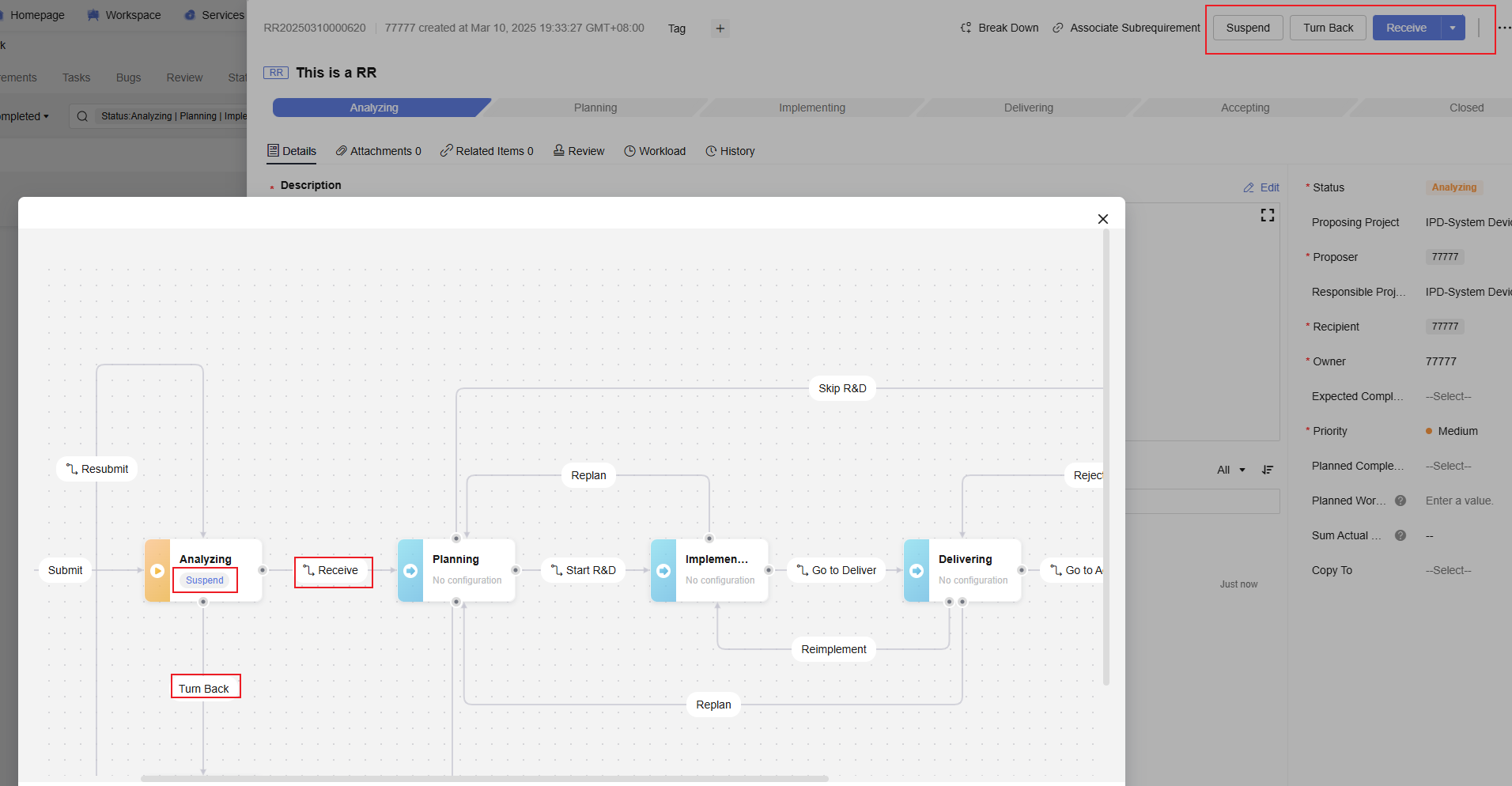

  8. Edit a transition line.
    1. Click a status flow transition line. The Transition Line Information page is displayed.
    2. Set the transition line information.
      The transition line information area displays the Start Status, Target Status, Transition Line Name (which is an operation button on the details page and can be edited), and Set as primary transfer parameters. Set as primary transfer is disabled by default. If the transition is set as the main transition, it is displayed as a main blue button on the work item details page to prompt users to perform the best operation during the transition. Other transitions are displayed as gray buttons. The following figure shows the transition line name displayed on the work item details page.
      Figure 1 Status flow in work item details
    3. Configure pre-transition verification. The transition can be performed only when the verification items meet the requirements. The verification items are described in the following table.

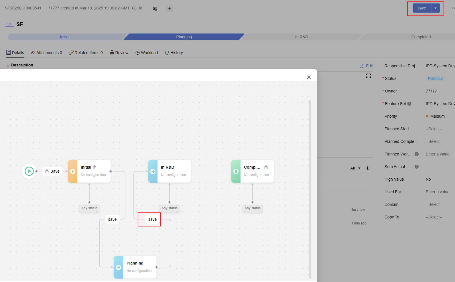

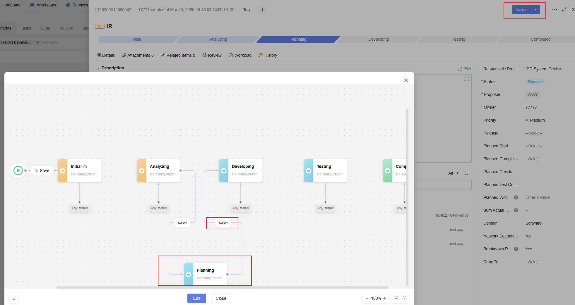

  7. Edit a status node of the status flow. To add a status node to the canvas, select the status on the status menu bar and drag it to the corresponding position.
    1. Select the status node to be edited. The status information page is displayed.
      Take the Analyzing status as an example. If you enable the Suspend/Cancel switch, when an IR enters the Analyzing status, you can click Suspend in the upper right corner of the details page and enter the suspension reason. Then, the requirement enters the Suspended status and is marked as suspended in the requirement list.

Customizing a Task Status Flow
  1. Access the CodeArts Req homepage.
  2. Go to a project and choose Settings > Work Item.
  3. Choose Work Item Management > Task > Status Flow. The task status flow page is displayed.
  4. Click Edit. The Task Status Flow Configuration page is displayed and the task system status flow list is displayed by default. The first record is the latest status flow, and the current status flow is marked in the list.
  5. Copy a status flow.
    • Add a custom status flow by editing a system status flow.
      Edit the system status flow and click Update Status Flow. The system displays a message indicating that the edited system status flow will be copied to generate a custom status flow. Click OK/Save. A custom status flow is added.
    • Add a custom status flow by clicking on the right of a system status flow.
  6. Add a node by referring to Adding a Node Status. A maximum of 30 nodes can be added to a workflow.
      Take the Processing status as an example. If you enable the Suspend/Cancel switch, when a task enters the Processing status, you can click Suspend in the upper right corner of the details page and enter the suspension reason. Then, the feature enters the Suspended status and is marked as suspended in the task list.
      Figure 2 Suspended task
      You can unsuspend tasks. Once a task is unsuspended, the suspension flag on the task name disappears. Click Cancel Suspension in the upper right corner of the details page to continue the process.
    3. Configure pre-transition verification. The transition can be performed only when the verification items meet the requirements. The verification items are as follows.
      Table 12 Pre-transition verification
      Verification Item
      Description
      Verify Operation Permission
      Optional. Check whether the operation role is specified before the transition. You can select one or more roles from the drop-down list. If this item is not configured, users who have permission to set the status of the work item or the owner of the current work item can perform status transition. If a temporary role is configured for the work item, this role also has permissions to perform status transition.
      Validate Field Information
      Optional. This verification is required by default. You can also disable it. If you enable the option, click Add Fields. On the Add Fields page, select the field to be added, set Field Value, and click OK.
      Verifying Associate Item Information
      Optional. This verification is required by default. You can also disable it. If you enable this option, click Add Associated Items. On the Add Associated Items page, select the desired associated items, select Condition (None by default), and click OK.
    4. Configure the in-transition page.
      Configure additional information that must be entered during status transition to proceed. The In-transition GUI Config switch is enabled by default and can be disabled. If the switch is enabled, click Add Field. The Add Field dialog box is displayed. Select the field to be added from the drop-down list and click OK. The field is displayed in the field list.
      If Mandatory is selected when a field is added, the field name in the field list is marked with an asterisk (*).
    5. Configure the post-transition action.
  9. (Optional) If you add a node to the canvas, draw connection lines using the mouse and enter the transition line name. Repeat steps 7 to 8 to edit the status flow node and transition lines.
  10. Configure the main navigation bar.
    Click Update Status Flow in the upper right corner to display the navigation for optimal work item transition. Drag nodes on the navigation bar to adjust their sequence.
    The default To Do and Done nodes cannot be dragged. If Transition from Any Status to This Status is enabled for a status flow node, you can drag the node on the main navigation bar. If Transition from Any Status to This Status is disabled and there is no transition line between the two statuses, the nodes cannot be dragged together, and the message This status cannot be transitioned. Orchestrate statuses again. is displayed.
  11. Click OK. A message is displayed, indicating that the update is successful. Go to the work item details page to view the status flow configuration.
    2. Edit the status information. You can set Suspend/Cancel and Operable project. Operable project controls whether members of the Proposing project or Responsible project edit, suspend, unsuspend, and change the status of a work item.
      Take the Analyzing status as an example. If you enable the Suspend/Cancel switch, when a bug enters the Analyzing status, you can click Suspend in the upper right corner of the details page and enter the suspension reason. Then, the bug enters the Suspended status and is marked as suspended in the bug list.
      You can unsuspend bugs. Once you unsuspend a bug, the suspension flag on the bug name disappears. Click Cancel Suspension in the upper right corner of the details page to continue the process.
      Table 15 Pre-transition verification
      Verification Item
      Description
      Click Submit to Fix. The required fields are displayed, as shown in the following figure.
      Configure work items whose values will be automatically updated after status transition. Update Work Item Fields is enabled by default and can be disabled. If the switch is enabled, click Add Field. The Add Field dialog box is displayed. Select the field to be added from the drop-down list and click OK. The field is displayed in the field list. If Mandatory is selected when a field is added, the field name in the field list is marked with an asterisk (*).
    The default To Do and Done nodes cannot be dragged. If there is no transition line between two statuses, the nodes cannot be dragged together, and the message This status cannot be transitioned. Orchestrate statuses again. is displayed.
