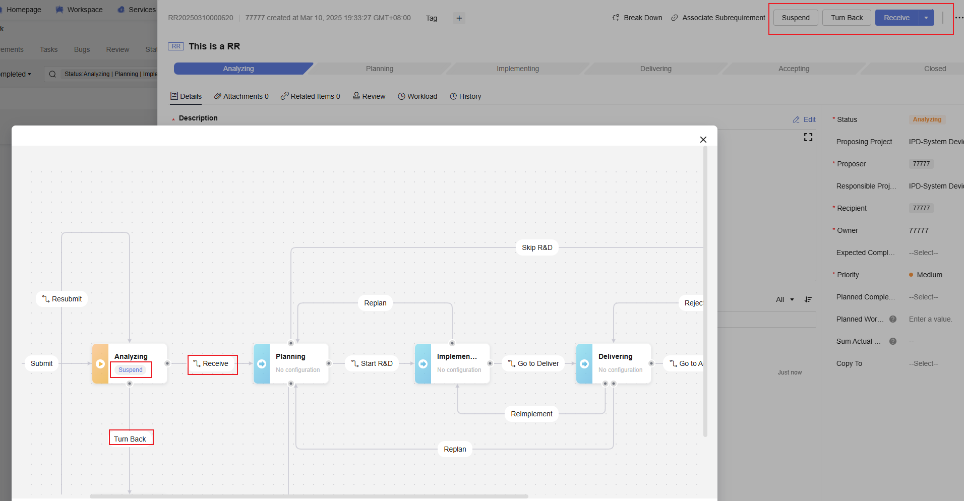

Customizing an RR Status Flow
- Access the CodeArts Req homepage.
- Go to a project and choose .
- Choose . The RR status flow page is displayed.
- Click Edit. The Raw Requirement Status Flow Configuration page is displayed and the system status flow list is displayed by default. The first record is the latest, and the current status flow is marked in the list.
- Copy a status flow.
- Add a custom status flow by editing a system status flow.
Edit the system status flow and click Update Status Flow. The system displays a message indicating that the edited system status flow will be copied to generate a custom status flow. Click OK/Save. A custom status flow is added.
- Add a custom status flow by clicking
on the right of a system status flow.
- Add a node by referring to Adding a Node Status. A maximum of 30 nodes can be added to a workflow.
- Edit a status node of the status flow. To add a status node to the canvas, select the status on the status menu bar and drag it to the corresponding position.
- Select the status node to be edited. The status information page is displayed.

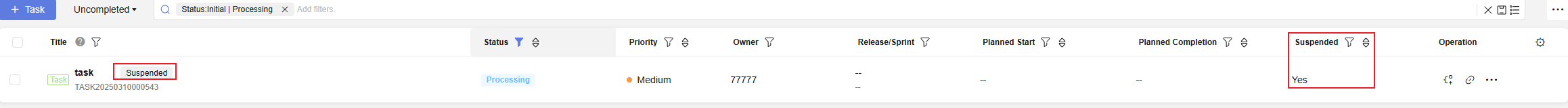

- Edit the status information. Suspend/Cancel is disabled by default.
Take the Analyzing status as an example. If you enable the Suspend/Cancel switch, when an RR enters the Analyzing status, you can click Suspend in the upper right corner of the details page and enter the suspension reason. Then, the requirement enters the Suspended status and is marked as suspended in the requirement list.
You can unsuspend requirements. Once you unsuspend a requirement, the suspension flag on the requirement name disappears. Click Cancel Suspension in the upper right corner of the details page to continue the process.

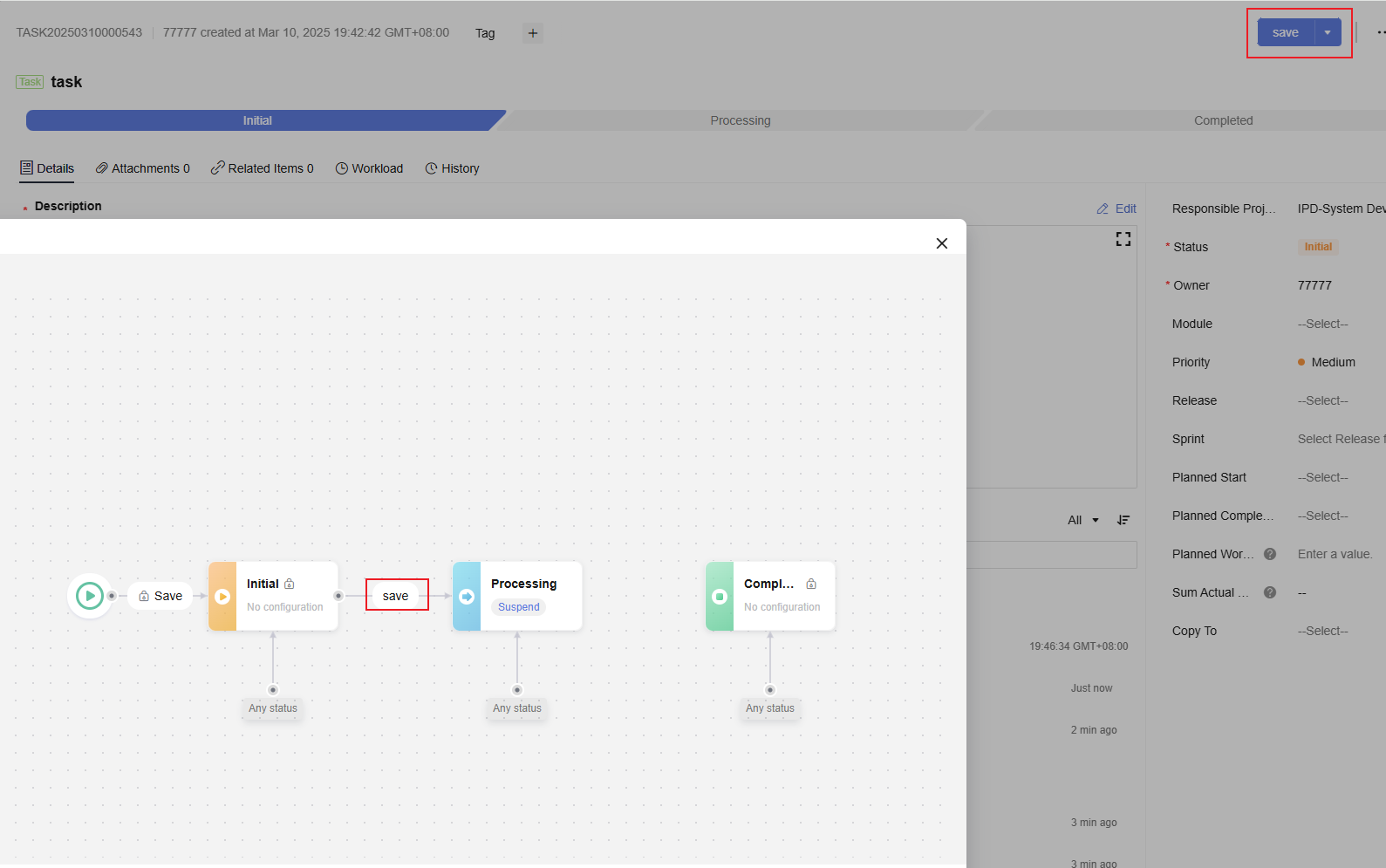

- Edit a transition line.
- Click a status flow transition line. The Transition Line Information page is displayed.
- Set the transition line information.
The transition line information area displays the Start Status, Target Status, Transition Line Name (which is an operation button on the details page and can be edited), and Set as primary transfer parameters. Set as primary transfer is disabled by default. If the transition is set as the main transition, it is displayed as a main blue button on the work item details page to prompt users to perform the best operation during the transition. Other transitions are displayed as gray buttons. The following figure shows the transition line name displayed on the work item details page.

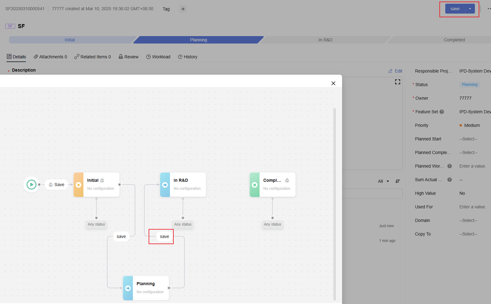

- (Optional) If you add a node to the canvas, draw connection lines using the mouse and enter the transition line name. Repeat steps 7 to 8 to edit the status flow node and transition lines.
- Configure the main navigation bar.
Click Update Status Flow in the upper right corner to display the navigation for optimal work item transition. Drag nodes on the navigation bar to adjust their sequence.
The default To Do and Done nodes cannot be dragged. If there is no transition line between two statuses, the nodes cannot be dragged together, and the message This status cannot be transitioned. Orchestrate statuses again. is displayed.
- Click OK. A message is displayed, indicating that the update is successful. Go to the work item details page to view the status flow configuration.

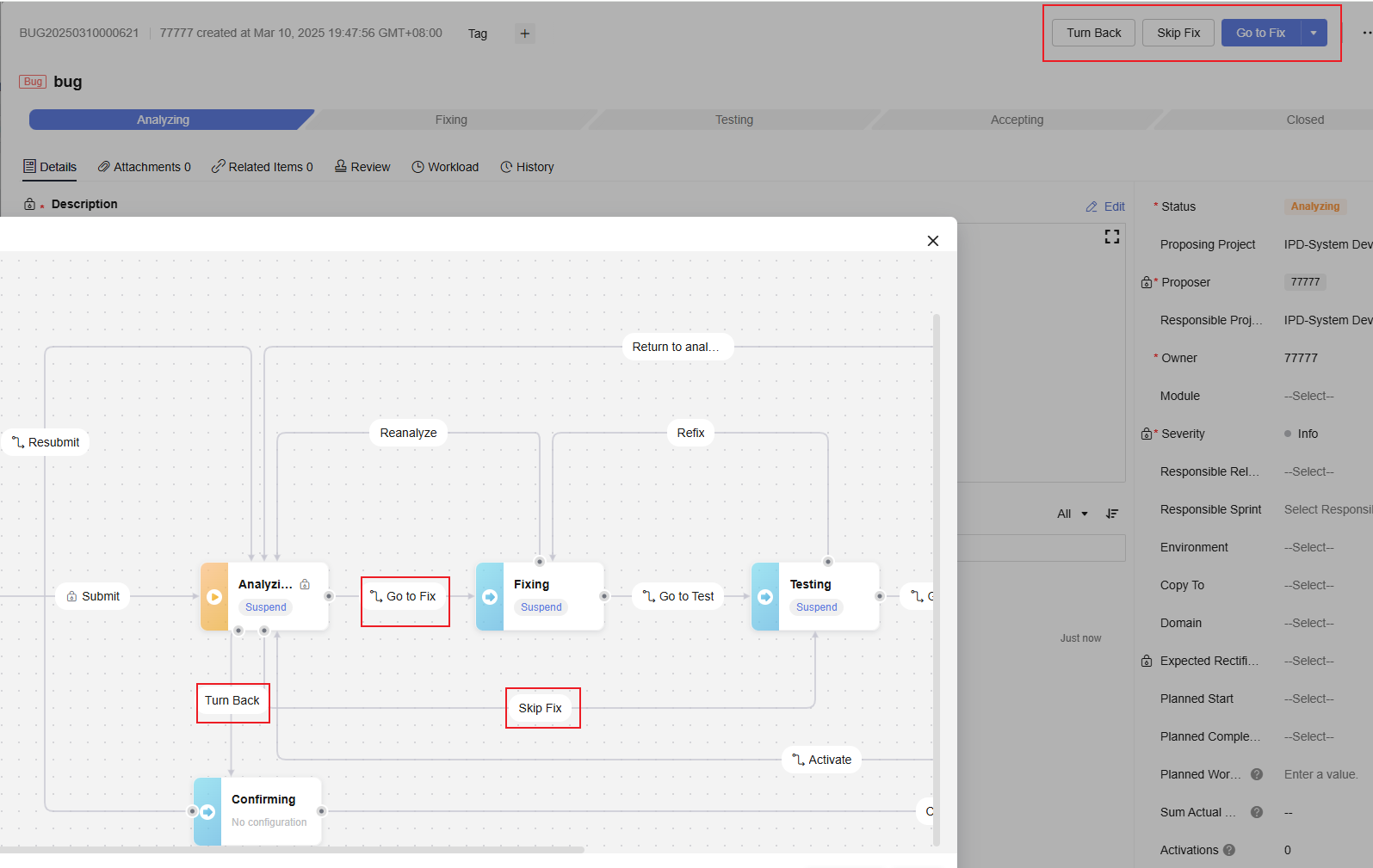

The default To Do and Done nodes cannot be dragged. If Transition from Any Status to This Status is enabled for a status flow node, you can drag the node on the main navigation bar. If Transition from Any Status to This Status is disabled and there is no transition line between the two statuses, the nodes cannot be dragged together, and the message This status cannot be transitioned. Orchestrate statuses again. is displayed.

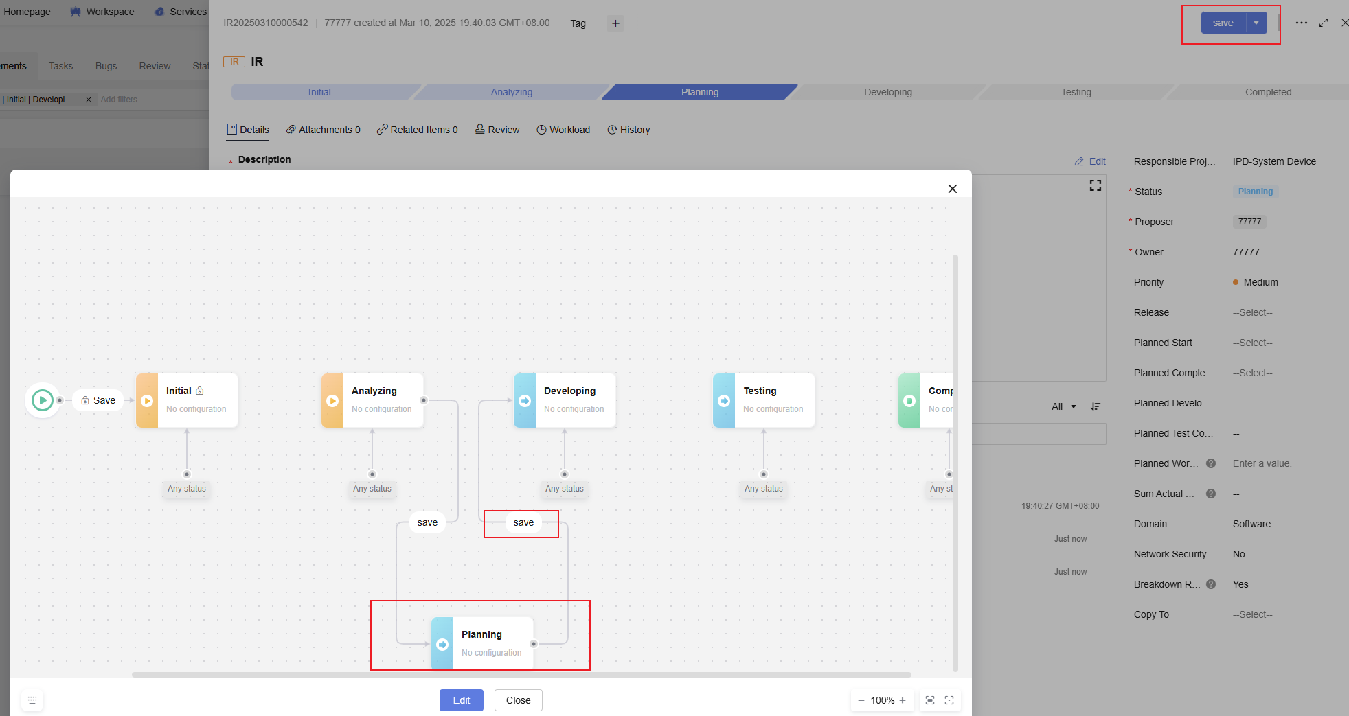

Customizing an R&D Requirement (IR/SR/AR) Status Flow
The following uses the IR status flow as an example. The SR/AR status flow configuration is the same.
- Choose . The IR status flow page is displayed.
- Click Edit. The IR Status Flow Configuration page is displayed and the IR system status flow list is displayed by default. The first record is the latest status flow, and the current status flow is marked in the list.
Take the Analyzing status as an example. If you enable the Suspend/Cancel switch, when an IR enters the Analyzing status, you can click Suspend in the upper right corner of the details page and enter the suspension reason. Then, the requirement enters the Suspended status and is marked as suspended in the requirement list.
Take the Processing status as an example. If you enable the Suspend/Cancel switch, when a task enters the Processing status, you can click Suspend in the upper right corner of the details page and enter the suspension reason. Then, the feature enters the Suspended status and is marked as suspended in the task list.
Figure 2 Suspended task
You can unsuspend tasks. Once a task is unsuspended, the suspension flag on the task name disappears. Click Cancel Suspension in the upper right corner of the details page to continue the process.
- Configure pre-transition verification. The transition can be performed only when the verification items meet the requirements. The verification items are as follows.
