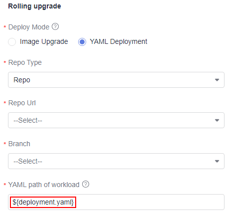

  • When configuring a release policy, you can use ${variable name} to reference an environment variable in the YAML path, for example, the workload YAML path in the rolling upgrade task.
    Figure 1 Referencing an environment variable

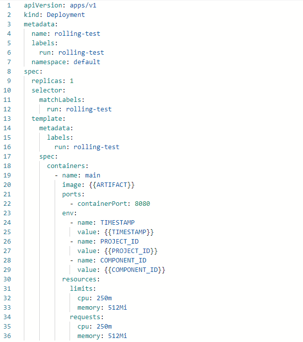

  • Use {{variable name}} to reference an environment variable in the YAML configuration file associated with the release policy.
    Figure 2 Referencing an environment variable
